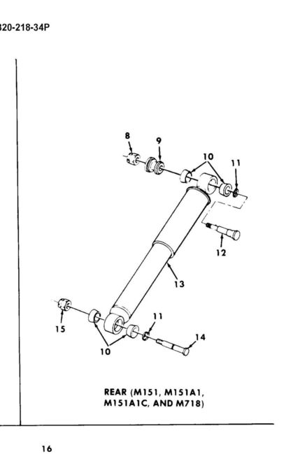

Thanks for letting me join today. I recently sold my ‘53 m-37 & my ‘46 cj2a ( downsized) so I could purchase a ‘ 69 ford mutt. Always wanted one and love it! One problem though was a passenger side rear shock that was making one heck of a rattle so I ordered a new shock along w the bushings & bolts.
Well after 2 days of trying to get the top bolt out with no luck ( pb blaster, tapping, etc) the bolt still wouldn’t come out so... stupid me used a sawzall to cut bolt. Well guess mistake cause the ( what I thought was a washer on nut side looks like it was a permanent “ spacer/bushing”?
Well it didn’t help as bolt although loose still won’t come out. Sorry for being long in the word but here’s the question, can I buy that “ spacer/ bushing? Looked online but can’t find. Thanks & don’t kick me out yet!

I think what you cut was a part of the body/ mount for the shock since the mounting for the shock is nothing more than the bolt as far as I remember. What it sounds like to me is that the bolt is rusted into the shock bushing. When you cut you needed to have the blade tight against the rubber bushing so as to only cut the bolt. You will probably need to do the same on the other side of the bushing but make sure you are ONLY cutting the bolt! If that piece you cut off is part of the mount as I think it is you will somehow have to weld it back on there, I don't envy you.

it may be that Range has cut part of the spacer sleeve (item 9) or the spring washer (item 11). If that's the case, he is fortunate. If he has cut the shock mounting bracket itself....he needs to get that fixed professionally. If the shock absorber tears loose during a turn........it's cheerio !

Ken, thank you for your reply & diagram.
I cut the bolt ( 12 ) and the outer washer ( 9 )
Dropped. The diagram doesn’t show what I think is a sleeve that was attached to (9) and what I believe (12)is stuck inside to. I have tried everything & (12) is still stuck. Guess @ this pt. Go ahead & cut other side of (11) at least on o/s next to bolt head? Thanks,

Range117, I for some reason thought you were working on an A2! If you are working on an A1 then Ken is right and you should be able to replace that washer with one from just about any shock absorber kit. Any shop probably has a few old ones laying around since new shocks all come with new washers. Sorry for the scare. :roll: :? :oops:

Ranger, the sleeve you are talking about is probably the sleeve that goes through the shock bushing and that is what the bolt is frozen on. That is not going to come out and should be part of the new shock. The part that fell out might or might not come with the new one but if it is not chewed up to bad it can be painted and reused. I would try to cut the bolt on the inside of the mounting bracket unless you think you have enough movement to get the stub that will be left to slide out.

Finally! After many bi metal steel sawzaw
Blades, I got smart &bought a Diablo carbide
Tip blade.. butter!
Now, could anyone help me find the washer/
Spacer that I so nicely chewed in half?
Thanks again for the reply’s & cant wait to drive it again ( with no rattle I hope)
