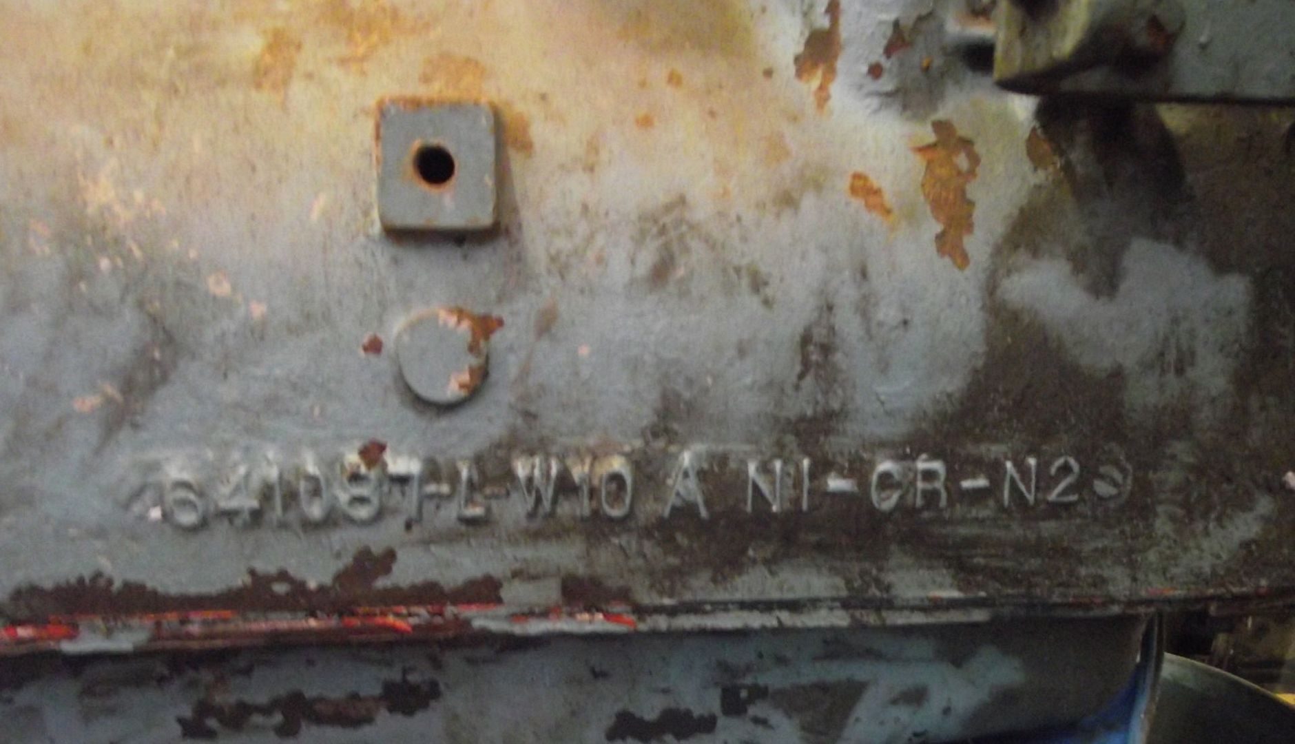

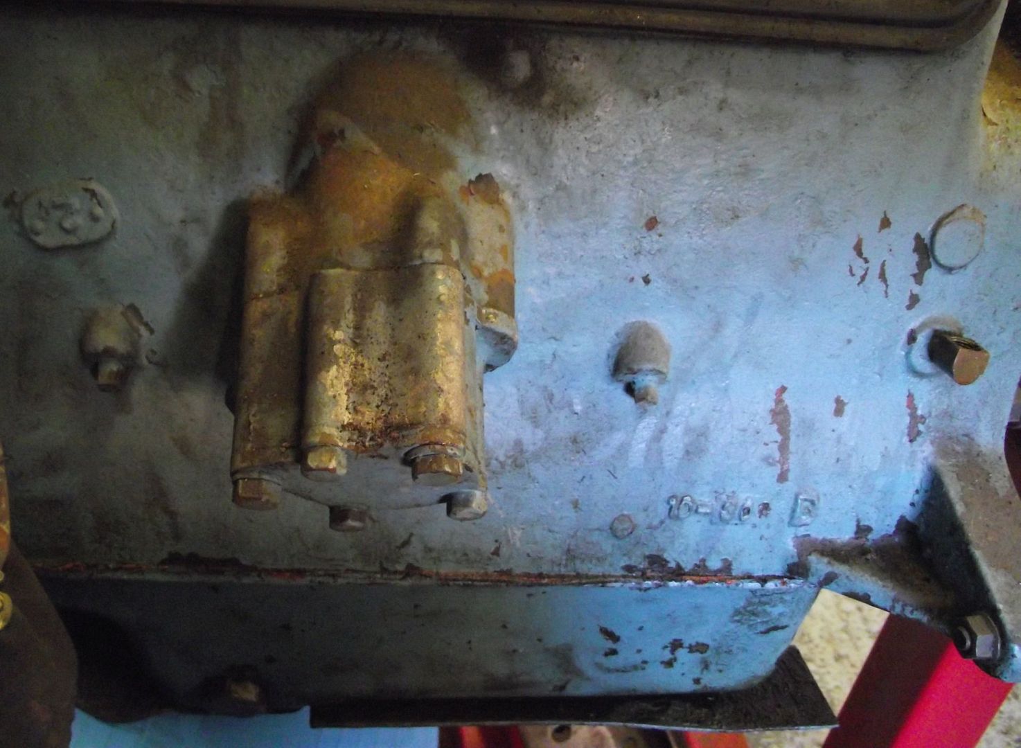

This is why I think I have an industrial engine, the head...
Or, do I have a CJ engine with an Industrial head on it? Here are the casting numbers and engine serial.
Right block...
Left...
Serial number...
I'm hoping I have a "car" engine, and that I can put an original GPW head on it to both increase CR and get a more accurate appearance. I don't have a problem with having the Industrial engine, the seller told me it was a post war engine, "probably" from a generator set. I have read some threads about sellers with totally original jeeps with these engine blocks fitted.

Nigelr32 wrote:...This is why I think I have an industrial engine, the head...
You have a "Model CJ-2A" short block. October 30, '48 casting (made while CJ-2A was still in production). This may have originally been configured as an industrial engine, or may have been put in a vehicle. The s/n alone cannot tell.
However, the short blocks are identical. The main difference between industrial and vehicular engines was the "bolt-ons": head, carburetor, possibly manifold.
