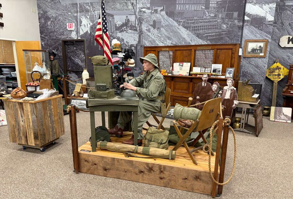

Hi Ray. Well, I'd love to take credit for the large US flag in the background of my display. However, it is a fixture at the convention center. The organizer that it would be a great backdrop. I was thinking it really make everything look small as it is one big beautiful enormous flag!
Thank you for the kind comments on the display. Kind of a last minute decision to put one together. Happy I did. Had a lot of nice comments about it. A little different than the standard vehicle display.
No VE Day events around here, but what a milestone. 80 years! What a generation!

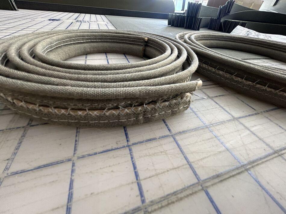

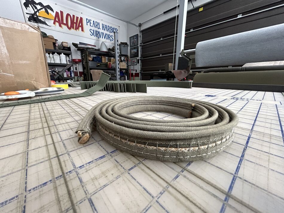

I have two rolls of the Wire-On Welting in OD7. No idea where this came from.
The canvas is sliver thin, and one can see the wire:
This is what it looks like folded over/pinched together. Pretty ingenious:
Sure wish I could find a source for the canvas OD7 Wire-On.

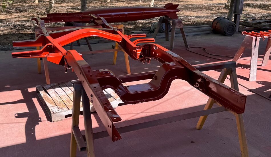

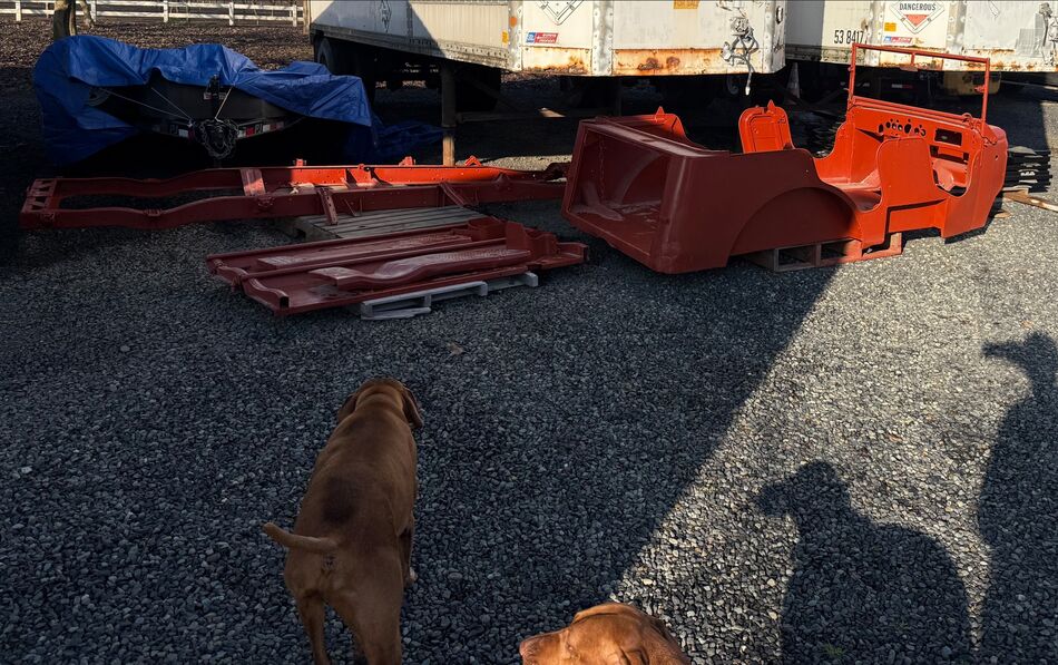

I did pick up more of my WC57 and WC22 projects after they were blasted and epoxy primed just before we left. Still need to figure out how to get the body and frame out of my enclosed trailer by myself. Took four of us to load everything when I picked it up.

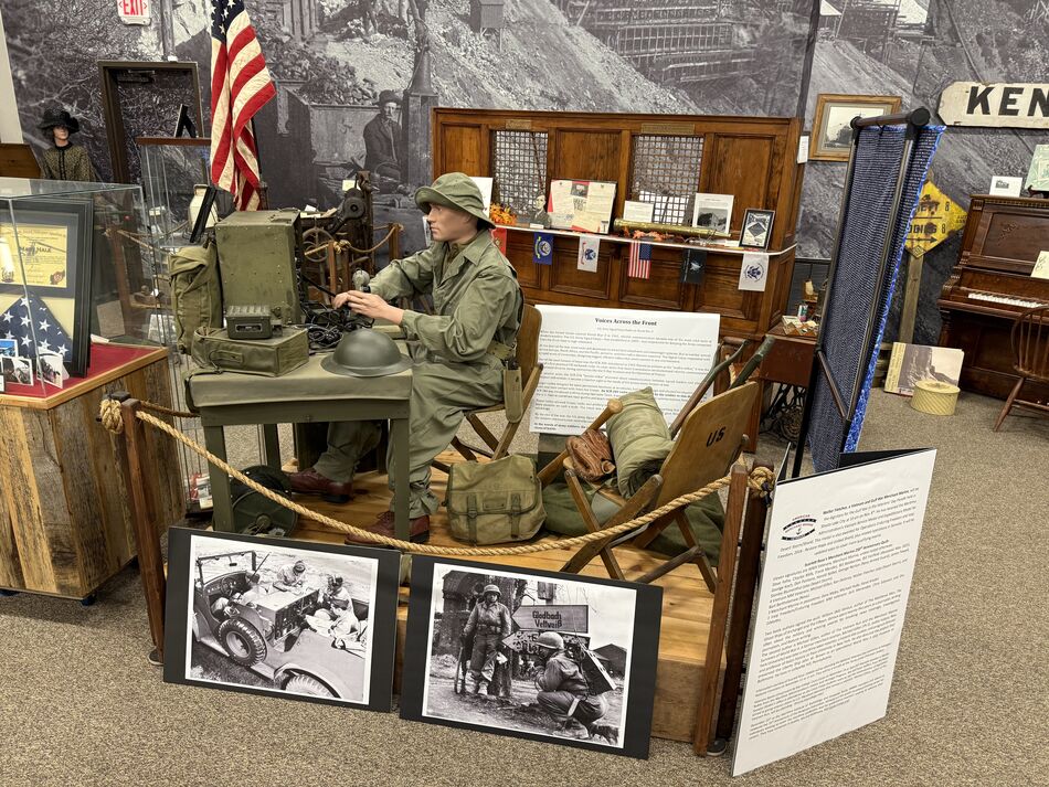

Also had set up kind of a early war Signal Corp radio display in the local museum for Vet's Day and over the holidays. Need to go collect all that tomorrow or so:
Had ChatGPT write up an full page on early war implementation of radios. Took like 3 seconds and it came up with the title. Where was that when I was working!
