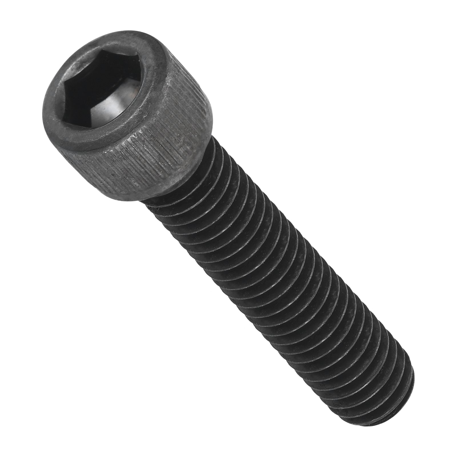

Some of the design aspects seem a bit strange. The 9/16" bolts are impossible to use any 'normal' tools on. There's not enough clearance to get a ring spanner on, or even a socket. I've just been able to use an open ended spanner, but that isn't really satisfactory, since you can't turn it very far before the spanner hits the hub. The fitting of the split pin isn't great either.

You might still be able to find 3/8-16tpi Allen head bolts to replace the hex bolts down under!

Excellent idea, I might just try that!Marty, SoCal wrote: ↑Sat Jan 10, 2026 10:06 amYou might still be able to find 3/8-16tpi Allen head bolts to replace the hex bolts down under!
