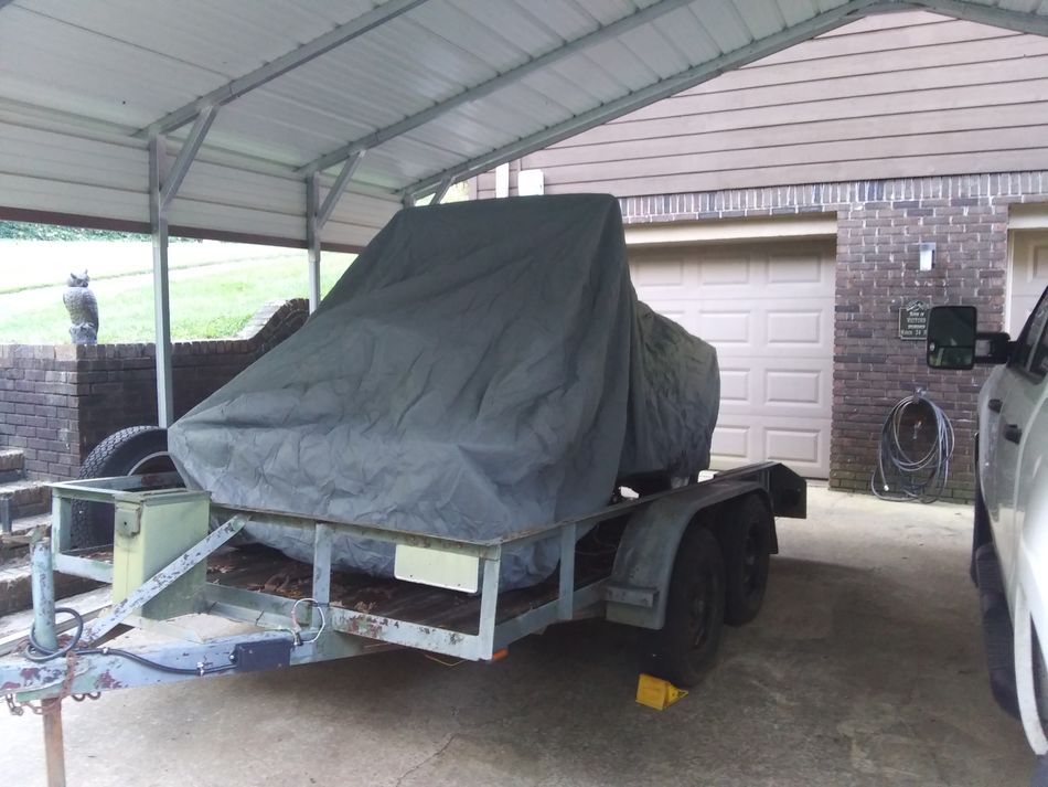

The CJ3B project had to move under the carport until this mule is finished.
