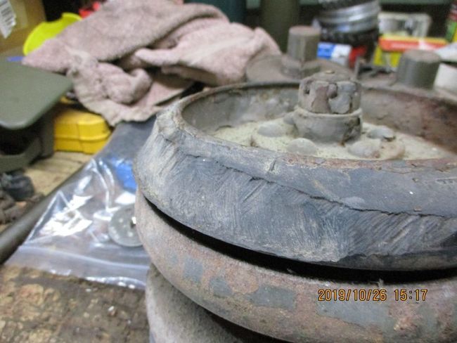

Today the gears were turning in the ole noggin Gents. I have an idea for Bogie wheels that may just turn out to a good one. Bogie Wheels are becoming expensive. I've seen them as much as $80.00 U.S. each, but no lower than $50.00. I had tremendous luck with 2 part Polyurethane rubber in the past. So I took out my Jig Saw and cut the original rubber away from the steel on one of my spare and damaged wheels.
All that is needed is to clean the rest of the rubber from the steel, build a small mold, mix the rubber with black pigment and pour it in. The resultant hardness of the mixed rubber is right up there with natural rubber. Since the wheel is just turning, the Polyurethane will stay in place for quite some time. This would be a pretty good fix for guys who don't have spares.

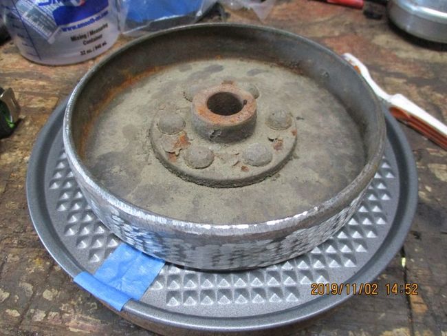

Well Gents, I have made good headway on this experiment. I was able to rebuild a bogie wheel, this is how I did it.
I didn't want to take the bogie off the cluster and lose all the parts that comprise a complete axle. I used a loose wheel instead. The tire had been gouged up by something so it was a good candidate for the experiment. An aggressive blade in the Jigsaw and three minutes saw the rubber fall away from the steel.
I trimmed the remnants of the rubber away with the saw, then cleaned this surface off with the wire wheel on my bench grinder and roughed the surface with my 4 1/2" angle grinder so the Polyurethane would be able to get "good tooth" on the steel.
I measured the old rubber to be approx. 7 7/8 inches in diameter. A non stick spring form cake pan was to be the mold. Here I have trimmed the center of the bottom of the pan to fit under the steel where the rubber will be poured.
I taped the joint and installed the pan onto the base.
I chose a hardness of 60 for the new rubber. It isn't too hard when fully cured, but may be too soft in the end. We shall see. All of the aforementioned work was performed on Saturday. The temps. have dipped a bit at night here, so the normal 16 hour cure time has been extended a bit.
I was able to free the mold from the rubber and here we have a freshly rebonded bogie wheel. The O. D. is just about 8 1/8 inches, but I'm thinking the additional 1/4 inch in diameter won't make a big difference in the end.
The big thing is to get the bottom of the cake pan out from under the new rubber. At this hour of the experiment, the rubber is still a bit sticky to the touch. So, I'm going to wait until the end of today before I attempt to remove it. The pan was a bit tough to peel away from the rubber. Perhaps because the rubber hasn't fully cured yet. So, a few more hours in the sun, and I'll try then.
So far and over all I'm deeming this a success. The 2 part Polyurethane rubber can be found anywhere across the nation. The kit I used was just under 32 ounces and cost $38.00. The black pigment was about $6.00 and the springform pan was $12.00. I am out of pocket so far about $60.00 and still have enough to mold one more wheel. I have seen N.O.S. bogie wheels on Ebay for $50.00 and $79.95 each. So I don't know which is the lesser of two evils, but I had fun doing this exercise and certainly wouldn't mind running these rebuilt wheels on my Weasel.

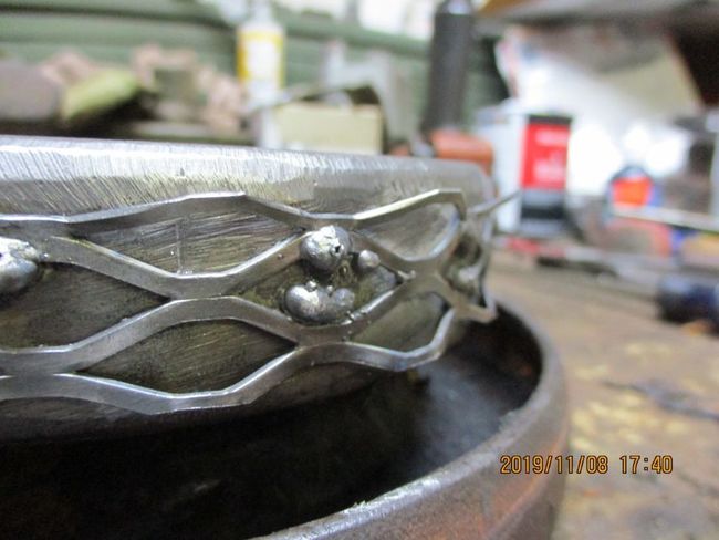

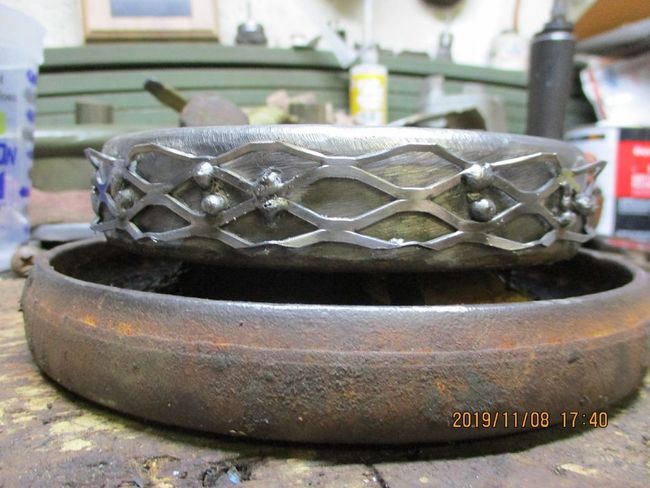

This photo is of the 2nd. pour I did several days ago. It is another test pour that I destroyed. I tooled the liquid rubber onto the mating surface with my caulking knife then finished the pour. It had a different mold bottom, and was unacceptable. I tried to push the rubber from the steel with my thumbs like I had with the 1st. pour, but could not. I tried prying with a screwdriver, the rubber bent but would not tear. I had to start its' failure by cutting the rubber with a razor knife. I had great difficulty peeling it off the wheel, then when I tried to break the rubber by pulling it apart, I could not. Its' tensile strength was much greater than mine.
Here I welded a 1 inch wide strip of expanded steel the mating surface, cleaned the slag and soot off, then bent the tops over. This will give the rubber more surface area on which to grab, reducing the the likelihood of delamination. I used cardboard as the bottom and backer rod cut in half to lift the edge of the cardboard bottom to mimic the original look of the wheel. I brushed in a light coating of release wax so the rubber wouldn't adhere to the cardboard.
This rubber is Shore A Hardness #80. It requires a 2 to 1 mixture, and I was far less generous with the pigment. This pour required 15 Oz. of rubber and 15 small drops of pigment. The pot ime on this hardness is 20 minutes with a full cure time of 48 hours. After the wheel comes out of the mold, I will heat the new bogey wheel to 165 degrees Fahrenheit for 4 to 6 hours to increase over all cure and tensile strength of the rubber.

Okaaay... With the refinements I implemented, I have been met with great success on the R & D of the project. I pulled the bogey from the mold and found that the hardness of the rubber is just right. I CAN'T budge it with my thumbs and I highly doubt that I will be able to peel the rubber away from the wheel because of the addition of the expanded steel.

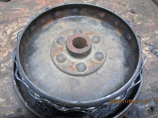

I molded another wheel today and I refined some of the preparation processes. This second wheel will be better than the first, I'll have photos if it out of the mold tomorrow.
For the second wheel, I changed the "direction" of the expanded steel. That afforded me the ability to bend the top edge of the steel away from the wheel to get a more desirable result. The Urethane will flow around the expanded steel, which will provide a better bond area.
I cut the backer rod 1/2 way through and worked it onto the edge of the guide portion of the wheel.
The backer rod is used to elevate the outside edge of the cardboard base to duplicate the angle of the original rubber. I used thin cardboard for the mold bottom.
After the cardboard is inserted, the joints are taped together. Then mold is fitted and the gap between it and the cardboard is closed with tape. Parting wax is then carefully brushed onto the inside of mold. The rubber is then mixed, pigmented and poured. This time I was able to use less rubber, 13.50 ounces. I hope to reduce the rubber usage to around 12.25 ounces for the final experiment. As for it, I'll make an exact reproduction of the bogey wheel. The makers mark, date code and original parting lines will all be visible in the new rubber. Just a note for anyone who has their Weasel painted White, I have a surprise coming with a special Bogey Wheel. :)
As for this portion of my research, I am calling it a flying success... Thanks for looking.
