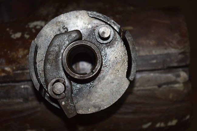

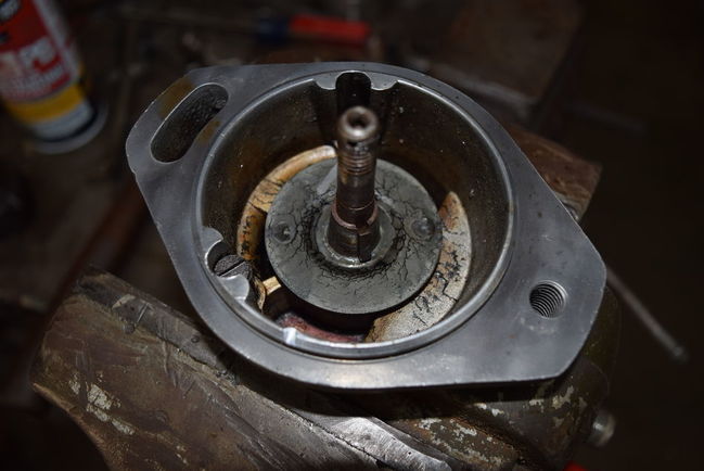

By manually turning the Mag gear you can check that the coupler spring is working. When you turn the gear it will spin easily until the pawl hits the stop pin then it will resist turning as the coupler spring tightens an when the outer coupler contacts the pawl it will release from the stop pin and turn rapidly with a resulting SNAP or CLICK.
The following pics will help you inspect the Impulse Coupler and check the Key.
Removing the Coupler
Coupler Removed
Coupler Top View
Coupler Bottom View check that the spring is present and working on the pawl. The 15 represents the Lag Angle or retard when cranking the engine manually. Using an electric starter generally spins the engine fast enough to pull the pawl in so the coupler does not engage.
