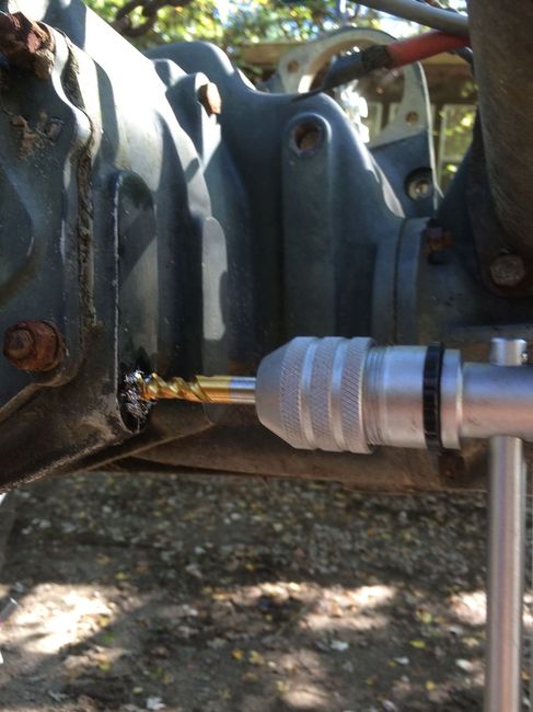

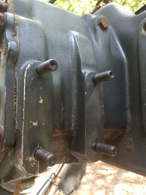

Look on the side of the transmission drivers side for the 4ea studs that retain the rear bell crank assy if it is smooth and no studs then my guess is someone installed an A5 trans axle into you A2 to complete or fix a non functioning A2 trans.
It can be drilled and tapped for 4WS this is my way of locating and drilling and tapping.
Caution: the top left hole can only be drilled about 3/4" deep otherwise you may drill into the reverse idler gear and snap off your drill bit that will now be in the transmission.
Marking for the 1st mounting hole
Drilling and tapping the first hole

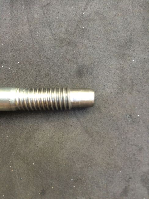

Installing 1st stud and secured with red lock-tite
Ready to Drill the other 3 hole using a drill guide
1 Stud installed and the other 3 holes drilled ready to tap

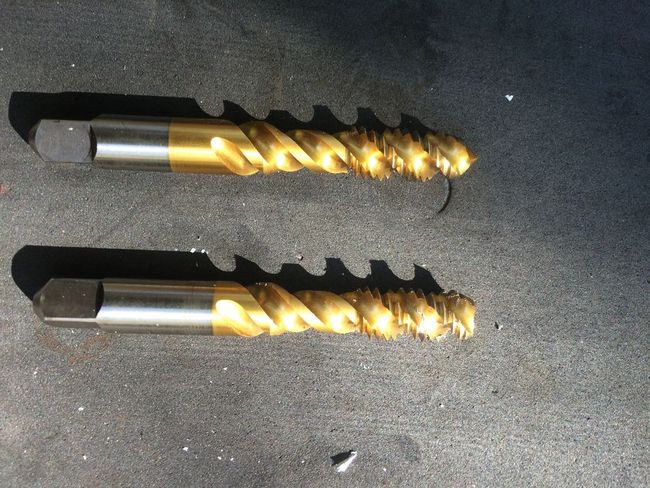

Using a tap guide I insert a bolt that is turned down to 5/16" to align the guide for tapping the other 2 holes then inset a bolt into one of the tapped hole and tap the 3rd hole. Then I remove the tap guide and use a bottom tap to finish.
Rear Bell Crank installed waiting for 3ea nuts and LWs

Charles, After looking at the Transmission left side, all 4 studs are there equipped and ready for the rear bell crank. That's a great tutorial and pictures of bell crank install. Thanks. Not sure if im going to make it four wheel. This one will be doing all the grunt work, worker MULE. definitely need new tires though.
