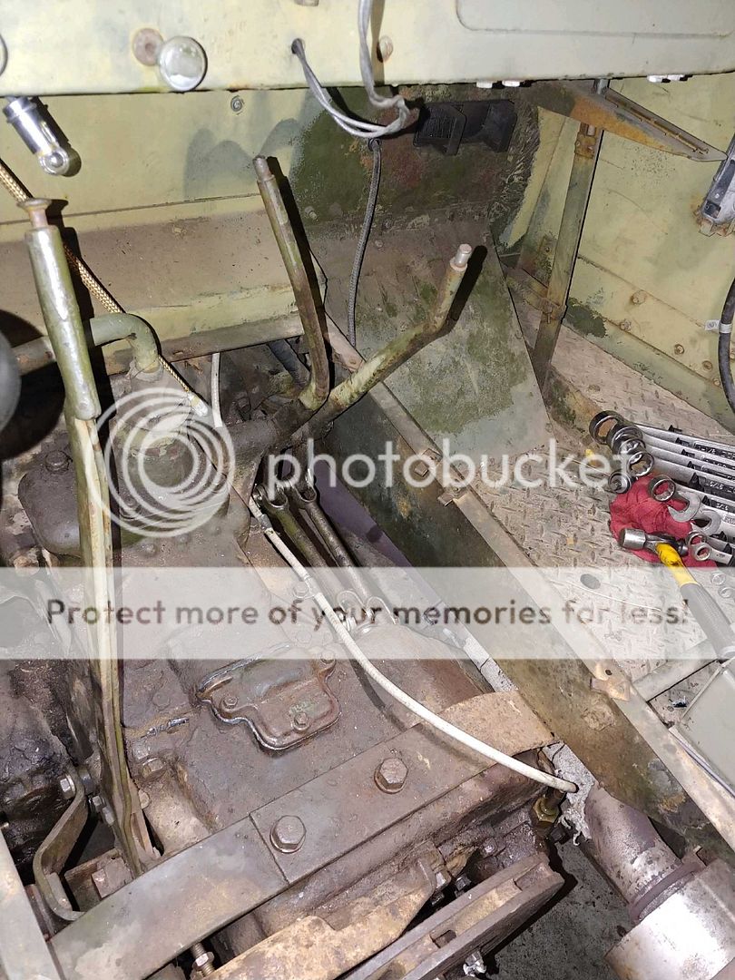

Here's a picture of the tranfer case seperate from the transmission. It pulls straight back and just has to clear the gear on the transmission.

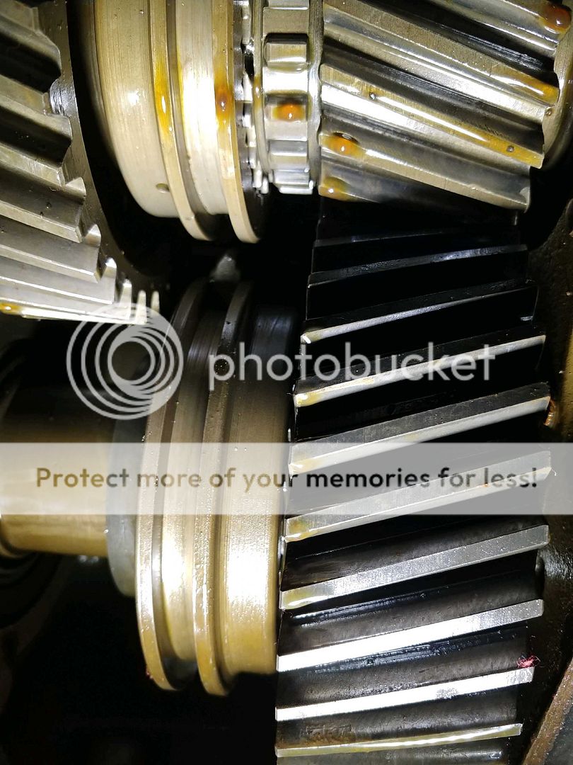

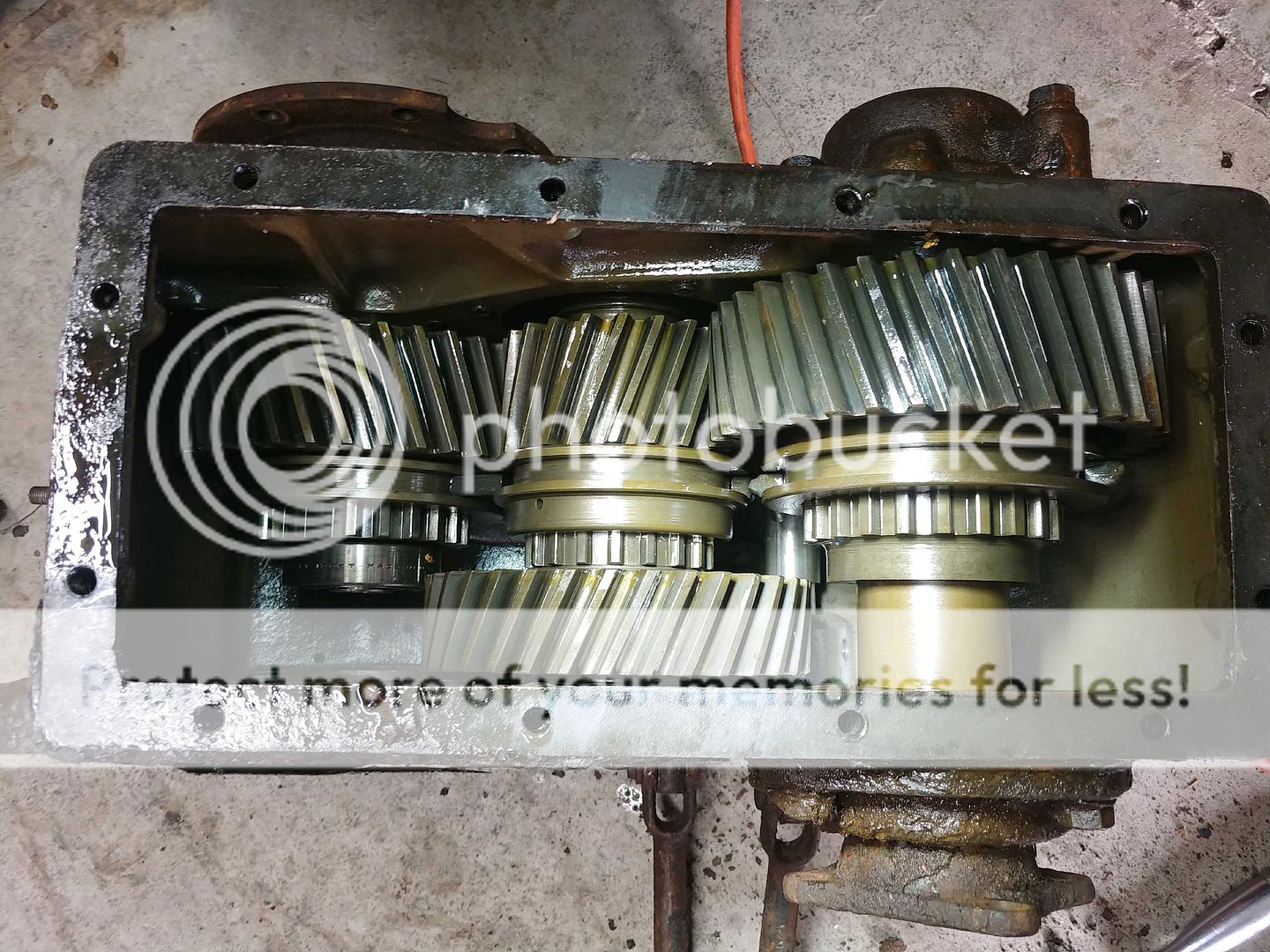

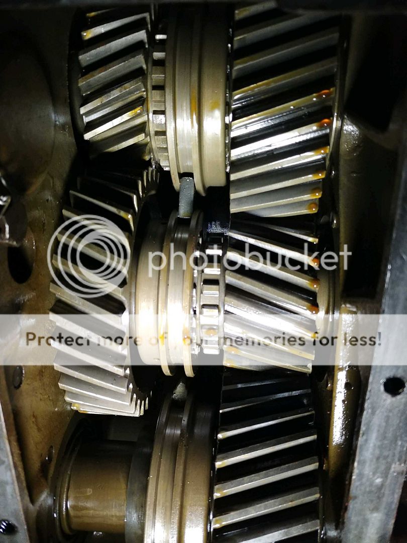

After the input I received and going thru the manuals, I decided to pull my T case (TC) this weekend and free up my hi/low and front wheel drive slides without pulling the transmission, PTO etc. After dropping the heavy duty frame cross member and pulling all those 76 year old cotter pins out of the 16 drive shaft mounting bolts, I pulled my driveshaft and emergency brake disk (I had pulled the front driveshaft years ago when recovering the Queen from the desert as the track was locked into 4 wheel high). I then pulled the emergency brake (I need new shoe linings!), the linkage for the winch PTO from the side of the case, and both shift lever cotter pins and clevis pins (The ones on the shift levers were relatively clean and I was able to get at the cotter pins….rear pins on the slides were a bit frozen up).
I was set to pull my TC. Pulling the plug and the pan draining the gear oil was a pleasant surprise as it was as clean and Carmel colored as the day it was pumped into the trany. No burned odor or water. The inside of the case and the gears were as clean and shiny as the day they were manufactured NO PITTING. There were no metal chips on the drain plug magnet. There are seven external bolts that mate the TC to the trany and two internal bolts with wire that bolt the bottom of the TC to the trany. In addition there are two bolts from the top driveline support that bot into the top of the TC.
Once the case was out it was fairly easy to work the slides loose after pulling off what remained of the boots that once covered the slide at the TC and the sticky clevis pins. I was able to polish up both slides and in a very short time they were moving smoothly and with a solid clunk as the forks moved gears inside the case into their respective locations. I made a new gasket for the mating surface of the TC where it mates with the trany and then proceeded to put everything back together again. I picked up a trany jack from harbor freight which came in very handy for install and removal of the TC. It was nice to finally put the front driveshaft back into place after all these years. The levers shift very smoothly and I need to now source some new boots for the shafts, and a set of emergency brake shoes.
I managed to clean up my emergency brake mechanism to include all the adjustment screws/bolts before reassembly. The brake mechanism moves very nicely. I also installed a new speedo cable that I had purchased years ago and found in one of the many parts boxes I was finally able to go thru. Lots of stuff found that I’ve not seen since 2007.
