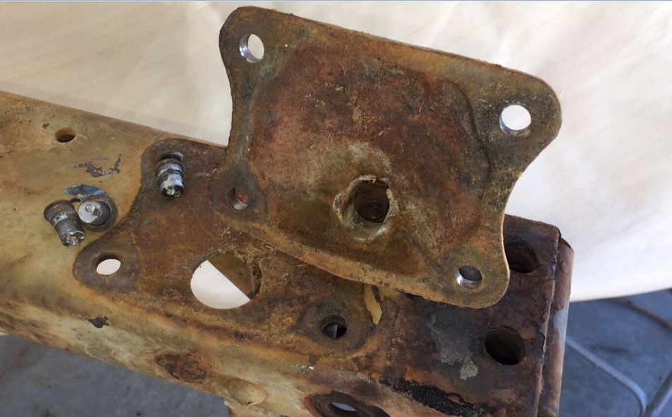

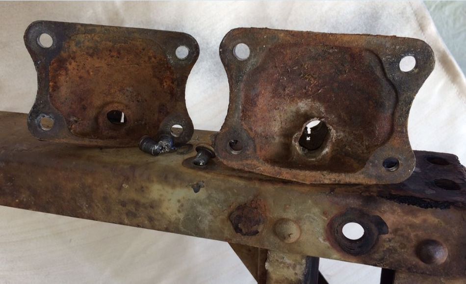

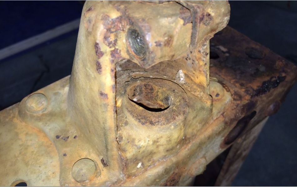

Post by Ghostrider5211 » Sun Oct 28, 2018 7:31 pm
Phase 1 of the WC-21 parts truck rescue is complete! There is nothing to do to this frame except trailer to my company's sand blaster booth and have them do their magic. Great bunch of guys... they blast my Dodge parts for free.
The two rear spring hangers are completely worn out and damaged. I am replacing both the spring hanger and the shackle on each side. There was severe corrosion on both sides, and the pins holding the springs in were rusted. That being said, the pins holding the FRONT of the rear springs in were very well greased and came out of their holders with great ease. Most bizarre thing I've seen. How do you maintain the front of the springs, but then leave the back end to completely rot out.

I made it back out to the truck last night after trimming some bushes for the wifey. I decided to try and get the two spring hangers off the back of the truck frame. I was successful. I used my angle grinder to cut the heads off the eight rivets and then simply took a hammer and popped them out. Now the frame is officially ready to go to the sandblaster.
The company I work for manufactures steel, aluminum, and stainless steel grating and planking. They have a *massive* sandblast facility there. I've been cycling most of the parts for me and dad's WC-55 project through the blaster, and they are more than happy to do it free of charge. I was talking to the supervisor of shipping and finishing about possibly coating my frame with something a little better than primer and paint. He made one phone call to his powder coat guy, and blam-o, a shipment of Olive Drab lusterless is on its way! Came pretty darn close to matching my paint chip! So, I'm excited to move the frame out and get it blasted, repaired, and powder coated.
You can see why I needed to remove the spring hangers. Both of them were completely shot. I have a new spring shackle and hanger ready to install, and I've got another set coming soon.

That's great on the sandblasting. That always slows me down as it is very expensive have done, and when I do it, it takes a long time.
I had a spring mount that was wollard out just like that on my Dodge WC16 project. Had to do the same...grind the rivets and replace it with a donor hanger. Pretty amazing that they wear out like that, eh?
Found some photos of it. Evidently, a lack of grease does have its consequences:
Removed and with the donor hanger:
Zeph

Hiya Zeph,
What's REALLY bizarre is that the two FRONT hangars of the rear springs... were full of grease, and the pins came out easily! It's like they maintained the truck until they hit the back of the cab, and then forgot the rear of the truck even existed.
I have one front spring hangar that is *slightly* wollard out. I think I can shim it and it'll be fine. I really don't wanna do any more cutting if I can help it.
I'm also reading your WC-26 Carryall thread constantly, watching how you did the springs and all the suspension and axles, as I'm right behind ya timewise... you do me a great honor with your presence on my forum thread, oh mighty savior of the Dodge trucks!!
