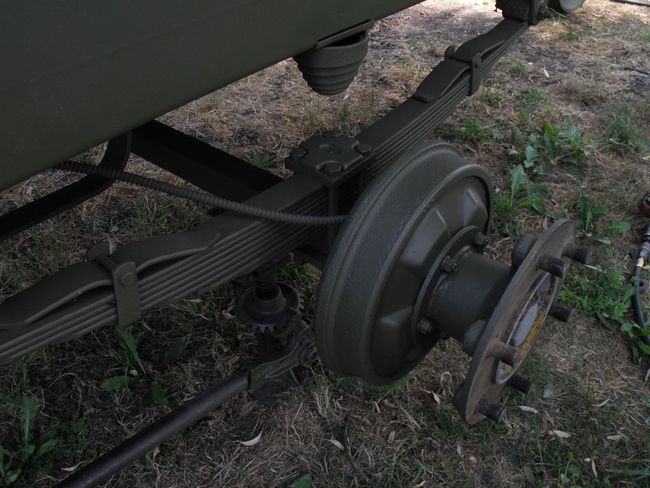

Fodder for the light fingered. Keep an eye on your trailer.

WTH?? I meant the picture was stolen... :roll: Do you know of a single case of a bracket being stolen off a trailer??

How does the bracket retain the wheel, I assume horizontal when it's folded? Does the wheel clip to it???
Is it something that can be fabricated or is it a casting? Maybe someone like Midwest Military could repop these :!:
Looks like Ted's trailer for sale below has one on it, too:

The port fork fits into the little bracket when the wheel is stowed for towing, Marty. As for the fenders, I purchased the very last pair. Which arrived today and made their way to the sand blasting shop.

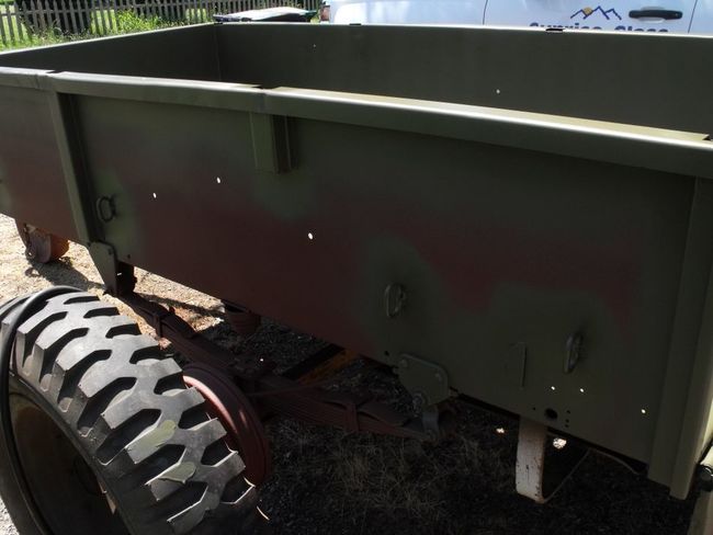

Well Gents, today felt more like Los Angeles than Seattle with the temps. reaching 95 degrees. Perfect weather for laying some 33070 on the trailer. Here are some photos of today's exercise.
Thanks John for the paint, I can always count on you to deliver the products I need to get my projects closer to completion. ALWAYS remember to protect you lungs with an Organic Vapor Mask when playing with noxious chemicals.
Here are my newly acquired N.O.S. fenders before paint.
I began by painting the inside of the bed first. I sprayed 2 generous coats here. I figured that after the generator is installed, I wouldn't want to break everything down again too soon to repaint.
Then I "cut in" areas that might be a little problematic as I sprayed the exterior.
Two heavy coats for the bow was in order.
OOOOHHHHH, them fenders!! :)
Almost finished.
I have a little bit of cleaning yet to do to the spare tire carrier and then I can paint the underside. I really wanted to get it into paint before too long. Stand fast for more, thanks for looking.

Gents, a little more progress was made today. After having had a small setback in the way of late model fenders not lining up with the mounting holes, I had the original fenders blasted. I primed them today and changed the tires over to a pair of 1941 wheels that I have been saving for some time. Here are some pics. of today's exercise.
First up is a photo of one of a squad of inspectors that were making sure I was doing things in a correct, orderly, military manner :wink: . There were about 6 of them patrolling around having a look at what I doing. They weren't sayin' much so I'm hopin' that "No News IS Good News"...........
This photo is figuratively and literally, "Cart before the Horse" :) , but sometimes things just work out this way. Actually the photo is of the tire I removed from the 1963 dated wheel, awaiting installation onto the '41 wheel.
Undercarriage shot.
I changed the starboard side first and took the photo of the port side upon completion. I can't remember the last time tires slide off the wheels as easily as they did today. I barely had to fight them at all. Also you can see the N.O.S. Late Model Fenders I purchased that won't fit this trailer, in the bed. :roll:
These are the original fenders that came off the trailer. I had them blasted, then I primed them today. Tomorrow they will be painted 33070.
After the paint has time to cure properly, I will install them and then build a mount that will incorporate the holes in the bed for the P.E. 95 and the P.E. 197. I don't want to drill more holes in the floor of the trailer. Thanks for looking.

Well Gents I had some time yesterday and today to hang fenders and install the gates on my trailer. Here are some photos of that exercise.
Thinking back to the beginning of my thread, what she looked like at the start and what it is now is as stark as day and night. Lotsa hours and lotsa hard work, the end result makes it ALL worth the time and effort!! :wink:
Stand fast, more inbound soon. Thanks for looking!
