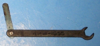

Post by Wingnutt » Mon Feb 12, 2018 5:12 am
Phil Jones posted this photo...
...on this random whatzit thread, which prompted me to look it up in the March 45 ORD 5 SNL J-4:
"41-W-1555 | A171152 | WRENCH, magneto, w/0.012 thickness gage, size of opening 1/4..."
Not sure if Phil owns the wrench or not, but it looks like an eBay ad photo to me.
