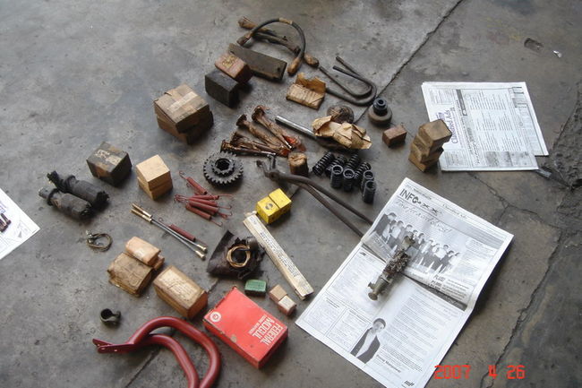

Many of these NOS parts are getting hard to find. I have a glass cabinet in my living
with some rare stuff. Like this NOS GPW spare parts kit:
Hinrik Steinsson
White M2A1 Halftrack
41 MB 103469 107069
42 GPW 51368
Dodge WC-16/26/51
M38A1 USMC MRC35
WD Motorbikes
philipj
G-First Sergeant
G-First Sergeant
Posts: 147
Joined: Thu Mar 19, 2009 4:19 am
Re: GPW 51368 1942 Restoration in Iceland
Post by philipj » Tue Dec 09, 2014 4:41 pm
Very well. I will let you know regarding any spares. Thank you. Super collection.. What are the contents of that kit? Sure the is a list somewhere...
Viking27
Posts: 2002
Joined: Mon Feb 24, 2003 11:39 pm
Location: Iceland
Post by Viking27 » Thu Dec 11, 2014 2:30 pm
Philip,
This is a complete kit of the spare parts which came with each jeep out of the factory. If I am reading
earlier posts right, then this kit was included in the wooden shipping boxes and when jeeps were assembled
the contents of this box would be removed and placed in a fabric spares bag and box thrown away.
The contents list tag is a repro. I would be very interested in buying a real tag to complete this kit
Reg
Hinrik
Hinrik Steinsson
