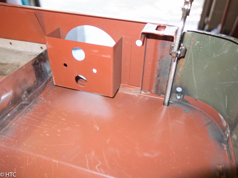

Once the driver side and floor reinforcing (see previous post) were done I put the tub on the frame in order to have it straight when putting in the toolbox panels.
I did not take any pictures of the process.
However you can see the toolbox panels installed in the next picture (not on frame :-)):
Now everything was ready for the rear panel.
This is what it looks like before welding:
You can barely see it on the picture but there was a gap of about 3 mm between the rear panel and the passenger side (the panel was 3 mm short or my tub with all the repairs was 3mm too wide?). Luckily it was not to wide :P
In order to fill the gap (and not have to 'force' the rear into a close fit), I did put a steel batten or ruler (do not know the english word) of 3 mm thick and with a width and lenght equal to the side of the rear panel in between.
After welding and painting it will be impossible to see this (if I do it right :-)).
Some pictures from the inside (before welding):
Driver side:
Passengers side (with the steel insert):
and finally one picture of the rear welded in and a detail picture of one side (where one barely sees the steel insert):
That is it for now. Next report will probably be about the windshield repair. We will see .....

Looks good, but I believe the rear panel isnt welded all over, it's more like strips of 1 inches long welds.
Like this :
Zeph's restoration. Great work nonetheless!

Hello Boyso,
Thank you for the good comment.
I knew that it is not welded all over and I did not weld it all over but I did more than 1 inch :oops: . Maybe 3 top and bottom. There must have been a reason that I did so much but I do not remember.
If 1 inch it is, 1 inch it will be ... (next time :-)).
