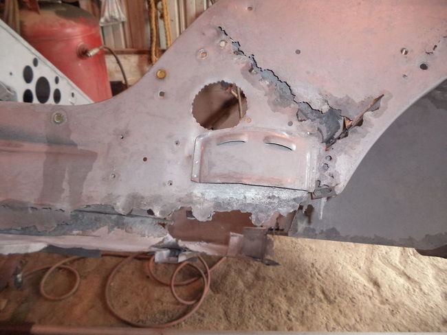

To add a little about the tub sheet metal resto...after it was back to bare sheet ,it was into Todd's garage.A first rate G503 tech- and generous friend.He did the sheet metal and I helped.
The front floor & hat channels were rotten,as was the driver's side panel from the center of the tool detents back.The floor riser was 1/3rd gone.Later we decided that the rear floor was too pin-holed overall to stay.Many extra holes everywhere,some braces and cowl pillars were also rotted.And more.

Post by Ralph » Mon Sep 12, 2016 5:06 pm
Here are a few more pics from before we started to show the overall repairs needed.At least we could reuse the front floor transmission tunnel.

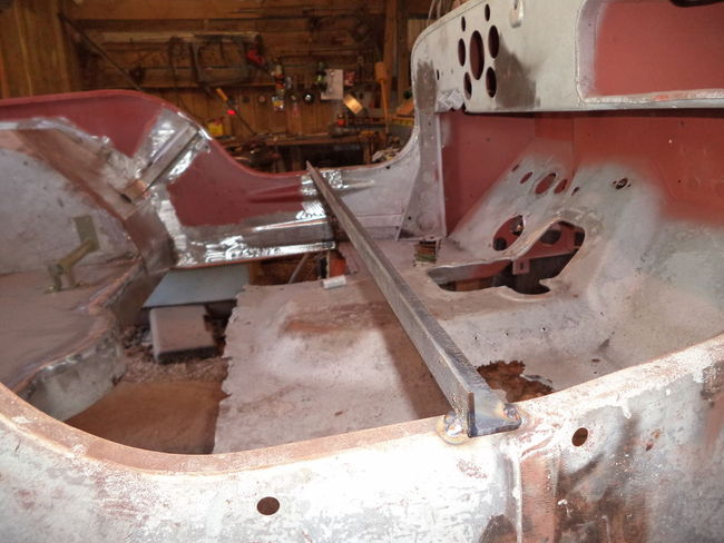

Post by Ralph » Tue Sep 20, 2016 7:09 pm
Getting the Driver side panel into place and tacking an angle across the door openings to keep her square.
Going forward on both sides,step and pillar repair
The finished DS
