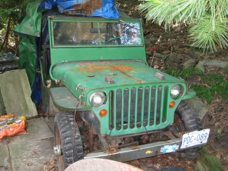

My dad bought this Jeep when we lived in monterrey back in the early 1970s.
At the time, he saved it from a V8 conversion and a number of other mods, but unfortunately he tossed the supposedly unrepairable tub and bought a repro 3A tub, then had a welder transfer a bunch of GPW features over to it. Unable to find an L head, he swapped the V8 for an F head.
He rebuilt the T84 after the V8 had mangled it.
I have very fond memories of riding in this jeep as a kid and the Jeep has had some "notorious" history while my father was in the RCAF.
I've got an ugly early WW2 GPW tub and the engine from GPW 27850 and am slowly trying to put her back together. Unfortunately, my dad chromed several parts ( hey! It was the 70s!) The blue sticker on the bumper (M38 unfortunately...) is from the Naval Post Grad School in Monterrey and the green sticker on the drivers side window is from the the RCAF fighter base in Cold Lake, Alberta ( both stickers around 35 years old)

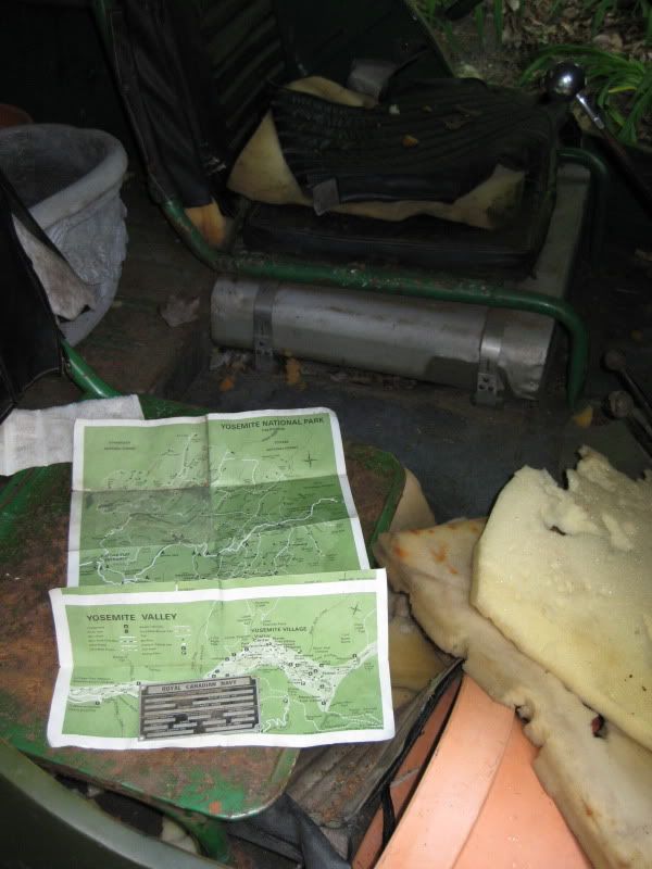

Found some cool stuff in the glove compartment like maps of Yosemite from the 70s...lots of good memories
Jeep was sitting for several years but got her started a few weekends ago with a new condensor and some fresh gas.
Frame is in excellent condition as he had it sandblasted and painted with urethane back in 72.

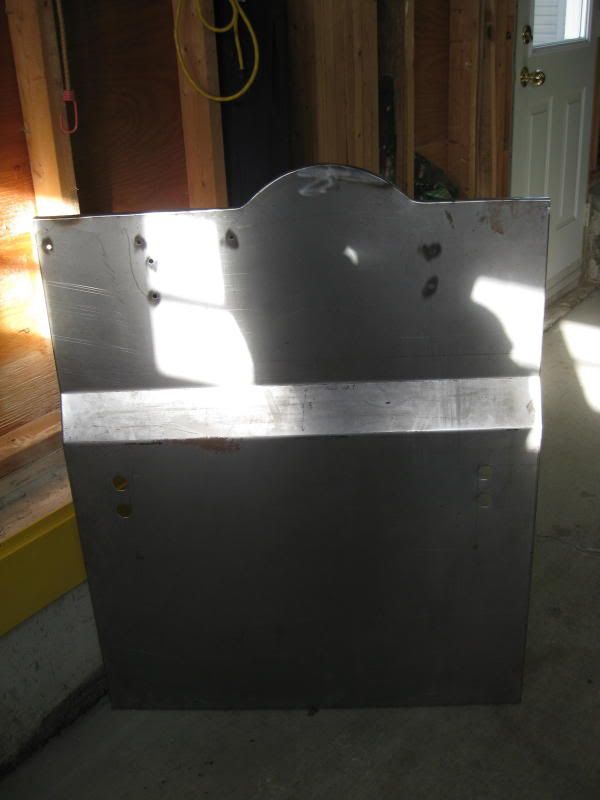

Got a bit more sheet metal work done on the rear wheel houses on the weekend. Dimensions from Jeep draw with some minor tweaks from actual measurements.
final comparison to ensure they were square and symetrical

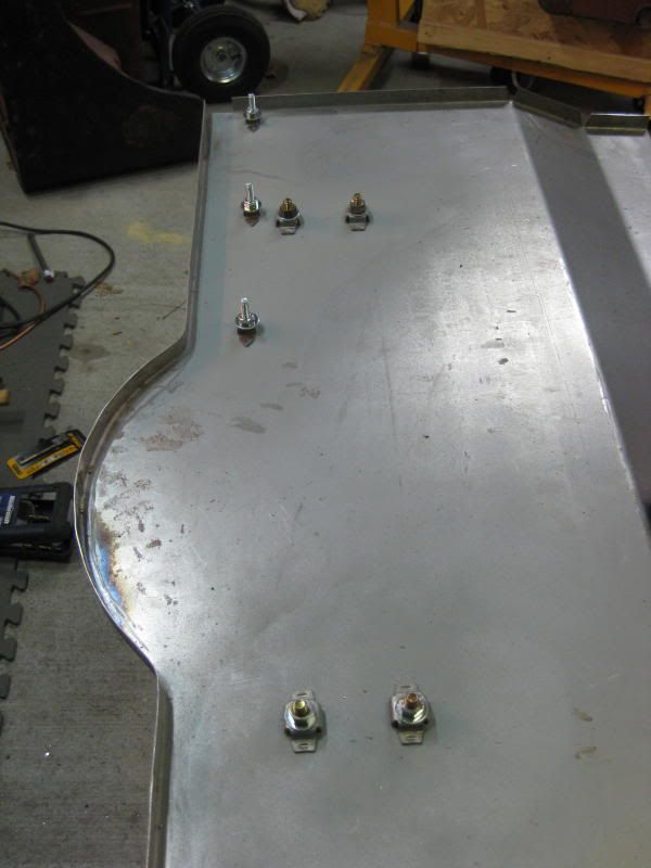

Now concentrating on the rear floor step repair pieces. I hoping to reuse the rounded part and graft in the straight sections.

Had a little more time to repair my rear step piece. It had been welded several times and had rust through ins a few places> Additionally something heavy was dropped on the rear floor which appears to have further distorted it. I decided to make my own repair pieces and to try to salvage the rounded part.
bent up some 18G for the straight part, then realized after I cut out the round part for salvage that the riser step was in fact 16G, so had to fab up again.
After a bunch of measuring and trimming to fit, I spliced in the new pieces.
once I was happy, I plug welded the riser to the rear floor I had already fabricated, then decided to mock it up with a salvaged wheel well side part and one of the new wheel house tops I fabbed up.
starting to come together.
