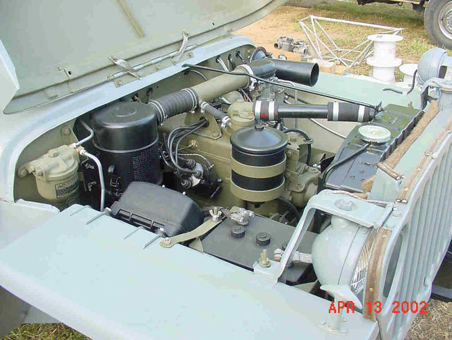

Post by Mark Tombleson » Mon Jul 19, 2021 10:32 am

Post by Mark Tombleson » Tue Jul 27, 2021 11:14 am
I forgot to include this photo!
