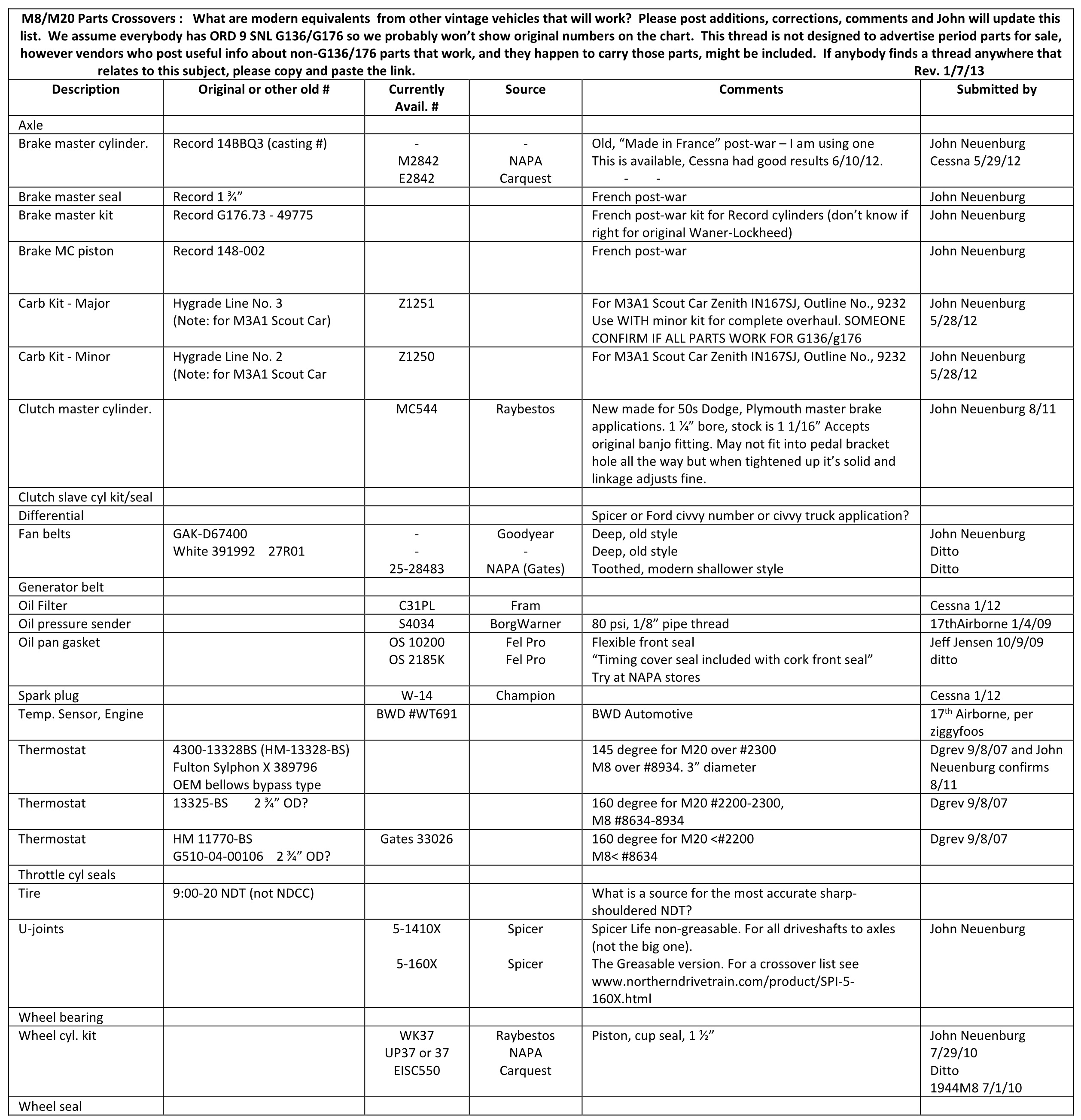

The following parts crossover chart is for M20 & M8 modern replacement parts OR vintage parts that will work but were NOT designed for G136/G176. Thanks to Ron for making it a STICKY!
Please read the heading :!:

Spark plugs... Anyone out there have a good cross over for that, or a supplier?

Spark Plug
Champion W-14
Oil FIlter
Fram C31PL

cessna wrote:Spark Plug
Champion W-14
Oil FIlter
Fram C31PL
Thanks. Updated it, and included u-joints

John, 17thairborne provided this awhile back for engine temp sender: BWD #WT691

ziggyfoos wrote:John, 17thairborne provided this awhile back for engine temp sender: BWD #WT691
steve
Good stuff, thanks!

Brake Master Cylinder
Napa number M2842
Hope this helps!

cessna wrote:Brake Master Cylinder
Napa number M2842
Hope this helps!
Brian
Wow that's a good one! Does this bolt right on? You using it?

As you know we are having brake issues with the M-20 we are working on. We isolated the Master cylinder and bench tested it, no good. The owner gave us a spare in a box with napa number on the outside of it. Unfortunately when we put about 12 pounds of pressure on it, all the fluid leaked out :( So I went to NAPA online with that part number... and it looks exactly the same as the one that came off!
It will be ready for pick up on Tuesday, so I should be able to give you a report Tues/Wens night. All we need now is brakes and a local farmer gave us his fields to play in in order to put it through it's paces.
This crossover chart has been a huge enabler with this project. It has helped us to no end; here is a picture of what your efforts helped to accomplish. I will start a seperate thread once we are done to show the progress.

A crossover chart is most useful when there is a lot of content. Thanks to you and others for your contributions! No doubt many people have tidbits of information filed away in their shop or computer that will flesh it out even more. Things like wheel bearings and other axle parts, engine accessories that don't carry the part numbers as per the manuals but are identical, wheel cylinders, filister head screws, etc.
Here are some photos of a NOS brake cylinder. Excuse the paper cosmolined onto it. I hope you take photos of your NAPA unit and post them for comparison. Also see some parts from the Record-brand kit G176.73 - 49775. Piston is 1.75". I am not sure if these French parts interchange with the original Wagner. Anybody know? I have photos of a Record cylinder around here somewhere.
Updated chart with this plus some zenith 29 carb info - am wondering if Scout Car zenith 29 kit is completely right for G136/176. Anybody try one? Jets same?
