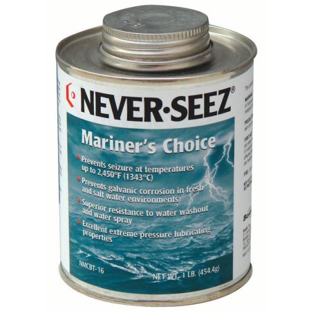

The aluminum spacer is most needed to protect magnesium from contact with steel. Bare steel and magnesium are highly reactive causing qalvanic corrosion. Use primer and paint plus plated bolts. I use Never- Seez Mariners Choice as added protection especially on the frame tube bolts.
