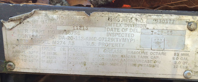

The Mules manufactured by Baifield Industries Emtex Division may or should have part of the Serial Number stamped into the underside of the top Foot Basket Bracket.
Data Plate for Lance W's M274-A5 Mule Registration #325091 Serial #10797
Underside of Lance W's Top Foot Basket Bracket The Stamped number is the last 3 digits of the Serial #10797
Another Baifield Industries Emtex Division Data Plate

That's very interesting! Do you know if it's just the Emtex machines or all of the Baifield-built machines? How about the Automatic Sprinkler Corp. Baifield Division-built A5 mules?The Mules manufactured by Baifield Industries Emtex Division may or should have part of the Serial Number stamped into the underside of the top Foot Basket Bracket.
Thanks!

According to your Reg # 02A-01696 I would say it was manufactured by Automatic Sprinkler Corp Baifield Ind
Two of my Mules were Manufactured by Automatic Sprinkler Corp Baifield Ind
Reg # 02A-22968
Ser # 12003
Date of Del 11-68
Reg # 02A-42768
Ser # 12201
Date of Del 1-69
Reg # 02A-22968
Ser # 12003
Date of Del 11-68
Reg # 02A-42768
Ser # 12201
Date of Del 1-69

My Baifield has the number 1190 stamped into the foot basket support bracket yet my serial is 11195 and my registration is 325489. This matches up on the plates
My data plates are original as well as the registration numbers painted by USMC.
An error on the assembly line?
Perhaps my plates were swapped and 11190 is stamped 1195 on the support bracket?
Chuck does 11190 appear on your list as I would be curious to know if that machine matches up to its stamp.
The mysteries continue.

The 02A prefix is for a U.S. Army registration number, not USMC, and the Army numbers are not in sequence like the USMC numbers, but I do agree with Charles that your machine is probably a mid-to-late Baifield-built unit, serial number in the 114XX range, probably built in Sept./Oct. 1968, but I think it is EMTEX, not Automatic Sprinkler Corp. because of the low, 4-digit number. I would look very carefully at your number and make sure that is a zero after the 02A prefix and not another number. Almost all of the Automatic Sprinkler Corp. mules that I have in my database with the 02A prefix have 5 following numbers with no zeros. It is possible that what you are seeing as a zero could be a 3? That WOULD make it an Automatic Sprinkler Corp. mule. I think John Emery has the correct reproduction Baifield/EMTEX data plate for your mule.
Just for reference, Baifield Corporation, including the EMTEX and Automatic Sprinkler divisions, produced 2,400 M274A5 mules between 1965 and 1969. Brunswick corp. produced the last contract batch of M274A5 mules, totaling 874 units, between 1968 and 1970.
