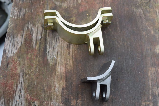

One pic of the location of the 2 WS Lockout bracket.
Two pis of John Emery's 2WS Lockout Brackets one is a clamp on and the other is weldable.
Cutaway of a Tie Rod End
C/L Location of the 2WS Lockout Clevis Hole. Close to 2-7/16" from Frame Tube Flange.
Johns Emerys 2 WS Lockout Brackets.

Lance-W
Posts: 318
Joined: Mon Oct 12, 2009 8:18 pm
Location: Simi Valley, Ca. U.S.A.
Re: My first Mule :) M274A5 1968 SN 10797 REG #325091
Post by Lance-W » Tue Apr 18, 2017 2:48 pm
John Emery really needs a website! Even if it only had pictures and you couldn't order from it. He'd sell a lot more stuff. He could just skip the E-commerce stuff and just put up a photo catalog. No one even knows this stuff is out there unless it's by word of mouth.
