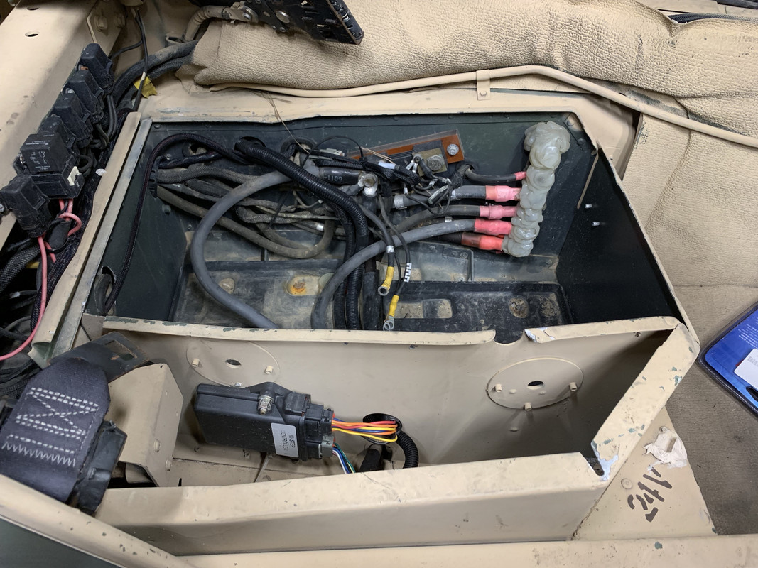

What are the specs for the black paint that is painted in the battery box. My HMMWV is green and want it to be correct color of Black.

I do not know the specs but it seems to be an enamel. It does get affected by acid so I don't know why they use it. Here is my new tub battery box.

It may just be that black is an easier paint to obtain in NON-CARC enamel application for motor-pools, so they ended up making the space black VS Green CARC which you would have to have a hazmat setup to touch up the paint.
Never seen a black area until your photos showed up in the above photo, but if painting black battery area I would recommend a bed liner type material for acid resistance.

If you want a good, durable black finish in your battery box use Rhinoliner or one of the numerous bedliners out there. They're the correct black color and are acid resistant.

The Rhino Liner Kurt suggested is probably as good as it gets and has the correct appearance. I used to use GI Issue Battery Box paint in my earlier M-Series Vehicles, it is not as durable.
