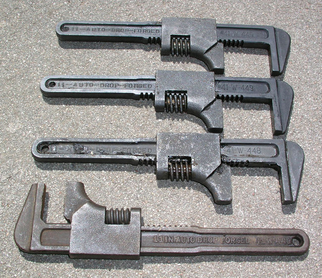

And this confusion extended to 11" auto wrench supplier Universal Metal Products in Los Angeles, Calif. Here are the front sides of four 11" adjustable auto wrenches made by Universal:

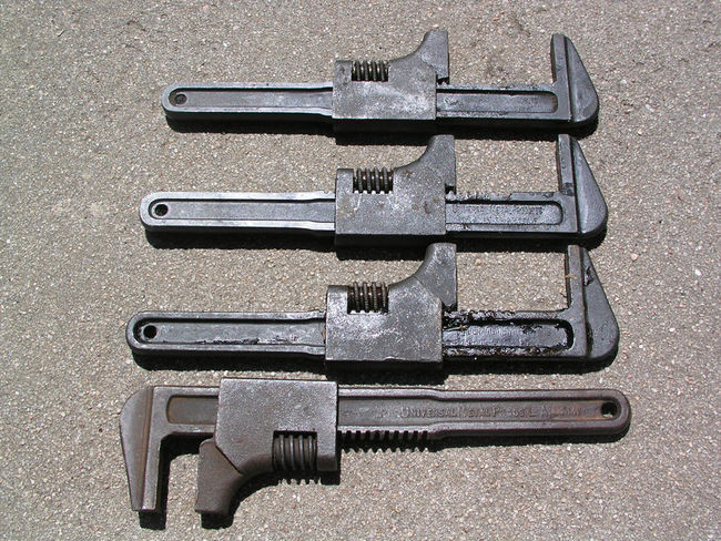

and the back sides:

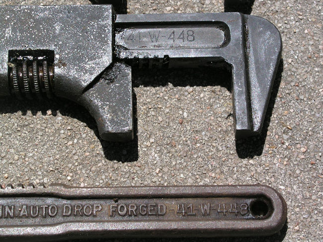

The bottom two wrenches are both 41-W-448:
with the lowest wrench having raised characters forged into the handle and the upper wrench having the FSN stamped into the opposite end of the handle. I think the lower wrench with the forged characters and no two digit delivery code in the factory address is the earliest of all 4 wrenches while the stamped 41-W-448 wrench with delivery code "23" between "Los Angeles" and "Calif." is the later of these 2 wrenches and the second oldest of the 4 wrenches.

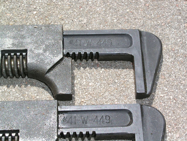

The top two wrenches are identical to the stamped "41-W-448" wrench except they have "41-W-449" stamped into them.

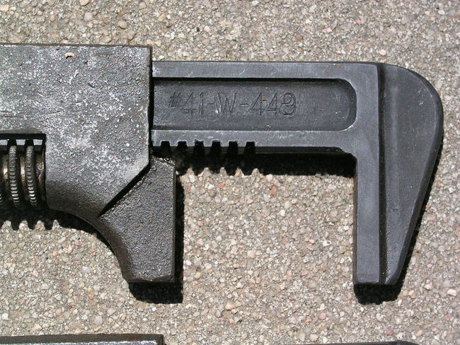

But what is most interesting is that the uppermost wrench originally was stamped "41-W-448" but was overstamped with "41-W-449", as can be seen here:
Is this the first documented case of jeep tool identity theft? :o This double-stamp "fix" suggests to me the uppermost overstamped wrench is the third oldest of the four Universal 11" auto wrenches wrenches while the lower of the two "41-W-449" wrenches with the clean single FSN stamp is the newest of all four Universal wrenches. The overstamping further suggests to me that "41-W-449" is ultimately the correct FSN for the 11" adjustable auto wrench notwithstanding the confusing and contradictory FSNs listed in Ordnance publications during and after WW II.
