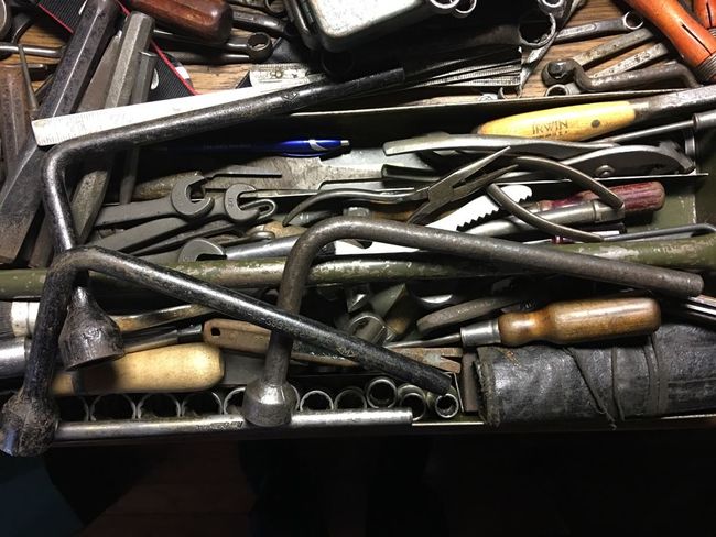

pjones
Posts: 2304
Joined: Wed Jan 05, 2011 3:26 pm
Re: Lug Nut Wrench
Post by pjones » Thu May 17, 2018 4:33 pm
Here are measurements from a couple of -55 wrenches I have and my Ford wrench.
-55--- .79, .79, .80
-55--- .78, .79, .79
Ford -- .79, .80, .80
phil

Post by Chuck Lutz » Fri May 18, 2018 12:31 pm
Phil....is your Ford wrench the kind with the 90* angle on it or the other, maybe 115* or so angle?
pjones
Posts: 2304
Re: Lug Nut Wrench
Post by pjones » Sat May 19, 2018 10:26 am
Chuck, Here is a photo of the wenches I measured. Ford wrench to the right and the -55 wrenches to the left.
phil
