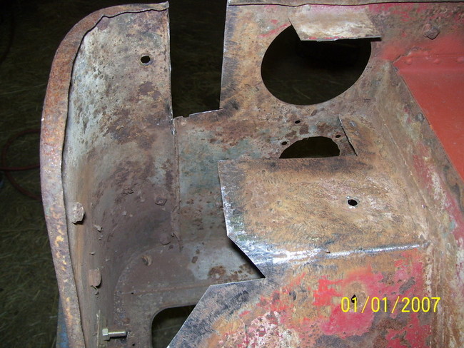

Hi all,
are there drain holes in the tool box bottoms? I have what appears to be a 3/8" hole in the center of the lh toolbox bottom,(other side is gone) :cry: the hole also has a clinch nut on the underside, (the nut looks like the ones for the tranny hump cover). Is this correct or a Bubba Mod? Thanks,

by Todd Haley
Frank, Now that you mention it, the hole is more than likely for the wire as the tub has the trailer mod. done to it. So, there is NO other holes in the box floor for drainage? There are no holes in the inner panel that would let water drain to the inside on my tub,(Ford Script) that I can find. Here's a pic of what I have to go by, anyone else have a pic of the tool box bottom on a Script tub?

by Todd Haley
Thanks guy's for the info! :) So, it appears that the Ford body did not have drains, and ACM II bodies had the hole in the inner wheel house. Now we need a few ACM I body reports to narrow down a timeframe for the addition of the hole.
