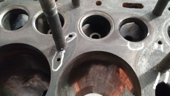

Hi all,
Thought you might find this of interest. I'm familiar with many of the usual places a GPW block cracks, but I don't know that I've seen them break like this around the head bolts and valve seats:
This engine, which is an early '45, was running when I bought it and I'm thinking it's worth putting back together and see if it runs without any issues. Worst-case scenario is if it fails, I'll have the spare '44 block that's correctly dated for my December '44 GPW bored, stitched, and time-serted to bring it back to life.
Anyone run into this before? Any ideas as to the cause?
Thanks,
John

Cracks around the head studs are not so common & can be caused by torquing the head studs into the engine block when they are meant to be fitted with sealant & just over finger tight.

Luc's spot on. I 've seen those same cracks on gpw engines a few times myself. Was worried the first time but the Engine ran without any problems. Got to say they were all on engines that had the heads bolted on. Don't recall seeing the cracks on later engines fitted with studs.

Now, when I have that, (common on GPWs as I assume Ford's casting house was taking some shortcuts), I always put thread inserts in the stud holes, and install hardened seats in the valve seats. Maybe not necessary but then I know nothing bad will ever happen to it. It's in the machine shop anyway.
Last one I did needed valve seats anyway as they had been ground too much.

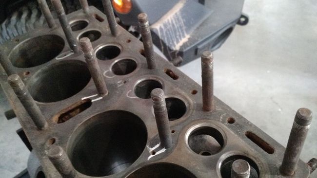

Maybe a bit off topic, but the mention above of bolts being used rather than studs answers a question I had about the engine I bought a few weeks ago. It is a WW2 engine, with head bolts rather than studs, and I was wondering whether that was original. Maybe, maybe not?
All of the other Jeeps I have owned have been post war, so the bolts struck me as odd.

What’s the date on your block? GPWs transitioned from bolts to studs in Nov/Dec ‘44 as best I know.

Overheating the engine over the years will also cause those cracks. you’ll be fine after rebuild

Depends on how many used Jeep engine blocks one has inspected. These cracks are quite common, especially on Jeep engines that have been driven while overheated.
