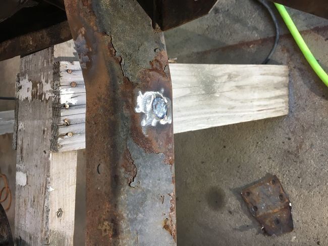

Got some work done on the frame today.
There were a couple of holes that looked like they were made with a torch rather than a drill. Either way I welded them up.
The "tabs" were cut off at some point and a big chunk of metal was welded where they used to go. I can't for the life of me find that picture, it was impressive.
No tabs
Making the new tabs
Tabs are back!
I spent some time removing the old brake lines and the axle bumpers.....then Ughhh....I broke a bolt off. Will need to work on removing that now.
I am hoping to get the frame sandblasted and in primer so I can get this part finished up. I sill have quite a bit of work to do first.....it seems after reading a bit here I should replace the frame, clutch and brake bushed bracket. Might as well just do it now instead of having to do it later. I also found that one of the spring brackets is pretty warn so likewise I will have to order a new one and replace it.

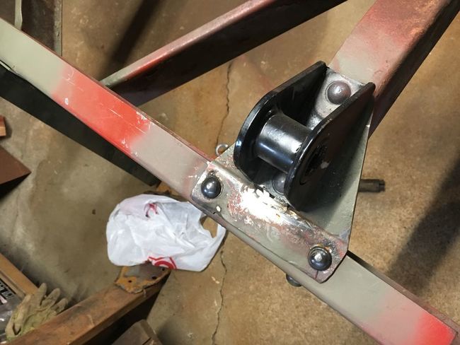

Ok....haven't posted in a while but have been making some progress. I'm sure you all know about getting obsessed about some aspect of the project. For me I really wanted to have real rivets on the frame. Thankfully @pittsjock agreed to help me out. So I loaded the frame in the car and spent quite a few hours in his shop. We were able to get all the frame horns, spring hangers and rear cross-member riveted back in place.
I think they turned out pretty good.

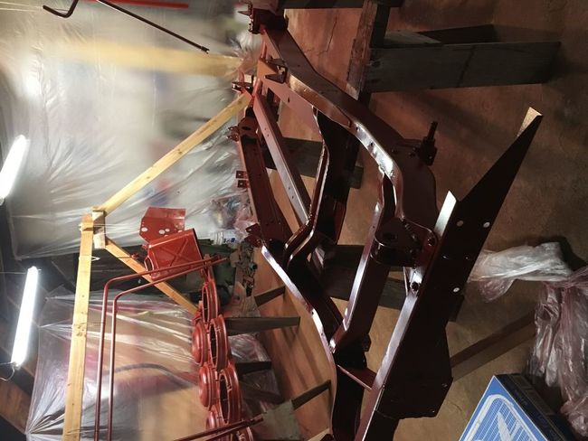

Next I finished up the frame but didn't take many pictures for some reason. Then I took the frame and some parts to the sand blaster
http://www.surfacezero.com/g503/data/50 ... dblast.JPG
Once that was finished it was time to prime.
