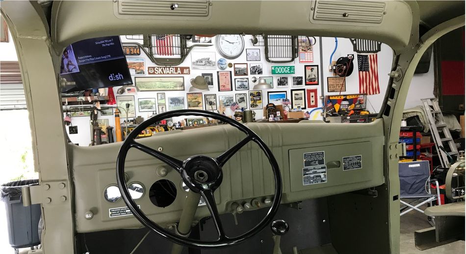

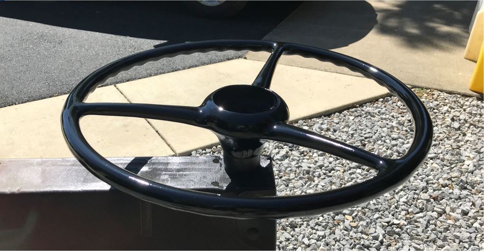

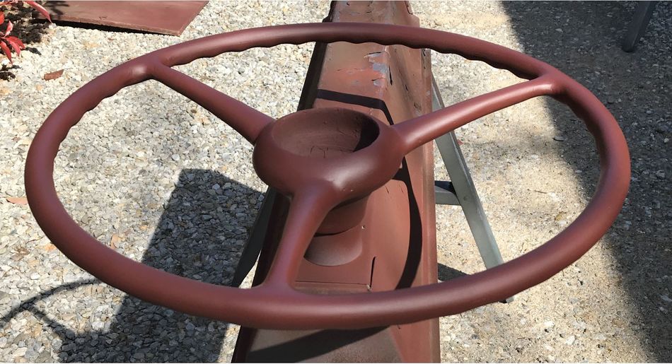

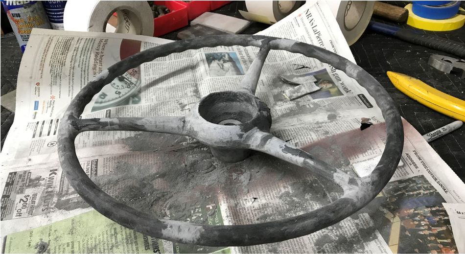

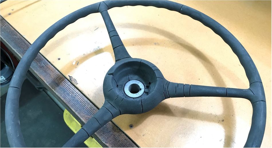

I recently used PC7 Epoxy for a 1941 Dodge WC steering wheel that was pretty rough. I would recommend it. Two part epoxy. Easy to apply and sanded down really nice. Here's a couple of photos:
Zeph
Frankie
Posts: 469
Joined: Mon Mar 14, 2005 2:44 pm
Location: Kansas
Re: Best Epoxy to repair original black Sheller
Post by Frankie » Fri Jul 03, 2020 5:41 am
Yeah, your steering wheel looks good. I'll check my steering wheel this morning; hopefully the JC-7 on mine is cured enough to sand. Did you have to allow lots of extra time for the JC=7 on yours to harden?
