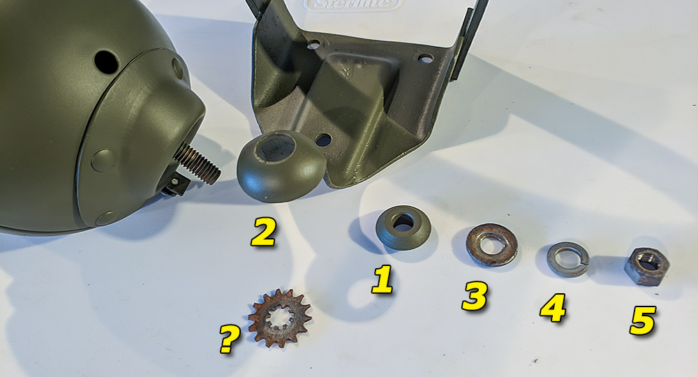

So, based on what I've read so far, should it go:
Blackout Drive Light, fat adjusting washer (1), BO Guard (2), Washer (3), Lock Washer (4), and Nut (5)?
So where would the star washer go in this lineup?

Hi Warbird, As has been said pull off that bit of rubber tube and then by the parts book, a 3/8 star (shake proof) washer is not used in this assembly but
5/16" shake proof washers were used in mounting the bracket to the fender to continue the earth return. So throw the bit of hose, put the bracket on the light stud, put the adjusting washer on with the large curved side toward the bracket, put on the lock washer, put on the nut. Now you should find that the light can swivel around to have the light point where it should. The mangled flat washer isn't listed in my parts book either. All of my books are for 1942 so if any thing changed some one else can correct. You need a parts book to avoid this confusion, its all in there, just got to scratch through it all. Alan

The toothed washer(s) goes under the fender where it can cut through and achieve a good ground. There are TWO of them, using the two bolts that hold the front of the Fender BO bracket.

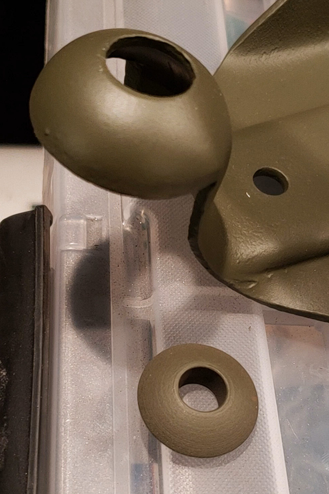

Hi,
With your numbering it should go light then bracket(2), strange washer (1) then 3,4,5.
The light, bracket and funny washer form a ball joint to allow light adjustment. The funny washer turns the concave surface of the bottom of the bracket into a flat surface for the lock washer and nut to secure against.

As mentioned #1 is upside down in your photo.

Scrumps, you are the man! Thank you! So, that leaves the question then, what all (in those bunch of washers/nut) needs to have metal to conduct the ground/neutral? I would imagine the 'funny washer' would need to have metal exposed to send back to the Blackout drive light guard which then has some exposed metal to send to the fender? I also would imagine the underside of the guard where it touches the funny washer would need to have exposed metal?
