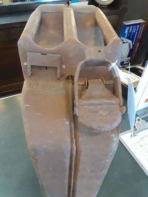

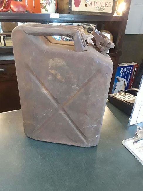

Conco can or German can? (I forgot to photograph the breather tube). It has a NATO tag bracket on it, so I'm not sure if it's U.S. or German made. Been trying to buy it but the antique vendor did not leave a price tag and the shop has been unable to reach her.

These should help...basically the US cans were spot-welded handles and the European were stick welded. The other differences can be seen in the type of closure hardware and of course the HOLE in the tab on the cap closure.
This one is half spot welded, and I guess the stick welded side was a repair. Strange it managed to receive a NATO tag bracket. So it looks like I have a Conco can. Excellent, thanks Chuck!

Here's another tagged can to decipher. It is not a CONCO, but The description of the can I have does parallel yours. Note the spring loaded tag holder and the tags.

I have only seen that type of TAG BRACKET on Swiss owned cans.
I cannot say that no other country used that bracket, but none that I know of.
BenDover's can was made post-WWII for Swiss Defence Forces.
It appears that right after the war, the Swiss used almost* whatever was available.
When the war ended, Europe was littered with millions of jerrycans that were no longer needed.
I have seen WWII dated British and German cans with these brackets that apparently the Swiss used after the war.
If a CONCO German style can was available, I assume they would have used it.
* I say almost, because I don't remember seeing any US screw-lid cans with this bracket.

Likewise, I have a 1944 dated British can with the same bracket, and have seen even war time German SS cans with the same bracket. Though I have always seen them referred to as NATO tags. Regardless, that is besides the point. The can is either a Conco can which found its way to and from Europe, or it's a European made can with a Swiss tag bracket.
