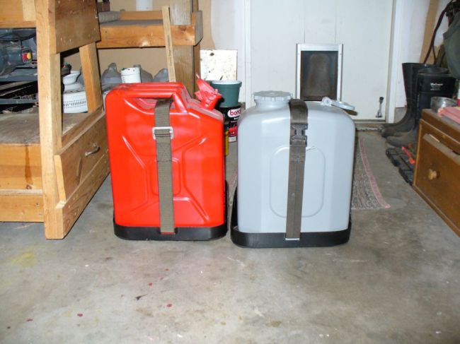

Try Rit dye.
https://www.ritdye.com/
I used some to change color on some gas can straps and it worked o.k.. Economical enough

What color of dye did you use on the gas can strap? Or was it a combination of colors?
I have a good condition original strap on a gas can holder that could use a "refresh". I also have a bunch of canvas that is close to "British Racing Green" that was used for a boat cover I'm thinking of using for the seat on a Cletrac. Trying to "adjust" that to a bit closer to O.D.
Any insight or tips welcome, thanks.

I only used one color but it was too long ago to remember any details. I think I posted it and will try to find it.

It was a long time ago but I found picture. it is darker than it shows and one is nylon and the other is not. 2009
