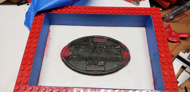

Thanks for the recommendation Dave. I corresponded with him a few months ago but unfortunately the maximum thickness he can do is 1.5mm. The Schelm Bros data plate, which needs to be etched, is a little over 4mm. The Fruehauf version needs to be cast, and this one is in the works right now.

Which one? The Fruehauf ones are in work...the Schelm Bros will be blank plates that I'll etch myself.
-Tom
Progress...cleaning up the original to make a silicone mold for the casting master:
