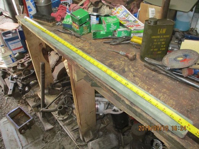

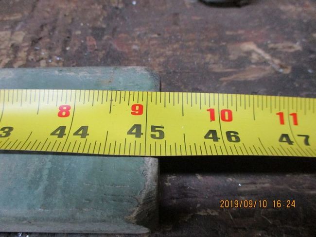

When I received my composite bed 2 years ago it came with ALL of the W.W. 2 wood. It was all rotten but I did some comparison matching of the "M" series troop seat hardware that I already had and what came with the bed. Two of the staves that Ben is asking about were falling apart but I was able to piece them together and compare them to my "M" series staves. They were the same length. Unfortunately I never thought to take a picture of the comparison. This is the best I can do Ben. 45 3/16".

Looks like my bench. :wink:
Thanks, you saved me from some work. When I first cut these,35 years ago I compared them to the steel stakes and came up with same 45 3/4". I have an extra steel stake and will see if I can double check the dimension.'I had some wood stakes from Euro returns back then and the dimrnsions deemed to jive. WWII Bows had more of an arch than M=series, I installed NOS M-35 Bows.
