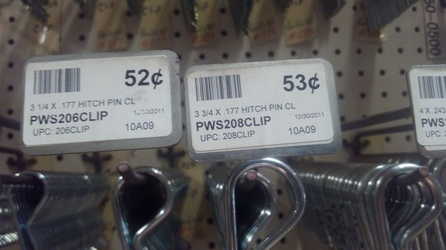

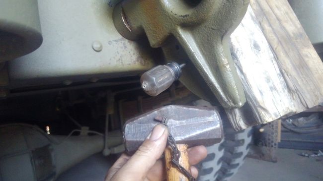

Here are a couple pic's of the Pintle Hook re-chaining. I got to poking around on the internet about Pintle lock pins and found some of the guys here had a thread on CCKW pins. I ended up selecting a 3 inch x 1/4 inch (7.62 cm x 6.35 mm) cotter pin. got the other 2 styles to see which one seemed right and I went with the short cotter with a slight opening of the tip to provide tension in the bore.
Here is the reference:
viewtopic.php?t=281492
I had remnants of the old chain sill on my Pintle, so I smacked out the old splined rivet and installed the new chain from a local hardware store and smacked the old rivet back in. I used 1 foot (.304 M) of chain and it seems to be a good length. It still seems easy to loose the cotter pin off the chain tho...

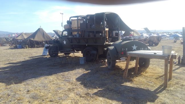

I got the old War Horse Loaded up and rolled out at O'dark thirty to the Chino air show and that was the first time I had pulled a "Rated Load" of 3500 Lbs (1587 Kilos), not to mention the gear I had in the truck which was about 1000-ish pounds (453 Kilos). I had to actually take off in 1st gear!!! The set up worked fine and no issues were observed.
I got back on Sunday to re-stow the gear at home and reached down and felt the rear axle hub flanges and they were warm to the touch, maybe 100-ish degrees F (37 degrees C) I thought to my self, "Wow, I was actually working the old Girl!!!"
She took it like a Champ!

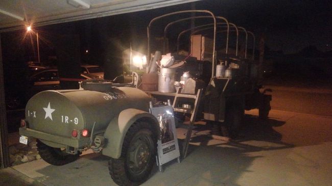

Yes, If you look at old WWII and pre-war documents/photos there are examples of them flipping the troop seats "Outboard" to use them as shelving. It is done mostly with 2 1/2 ton trucks, but it does say 1 1/2 truck too.
It works great! The seat legs rest on the outside of the bed running board, it is nice because you can stand on it too, but the rear most leg area is a bit flexy because the rear leg wont rest because of the diagonal brace on the rear of the bed...notice the big 26 inch door stars, the book is dated 1946.
