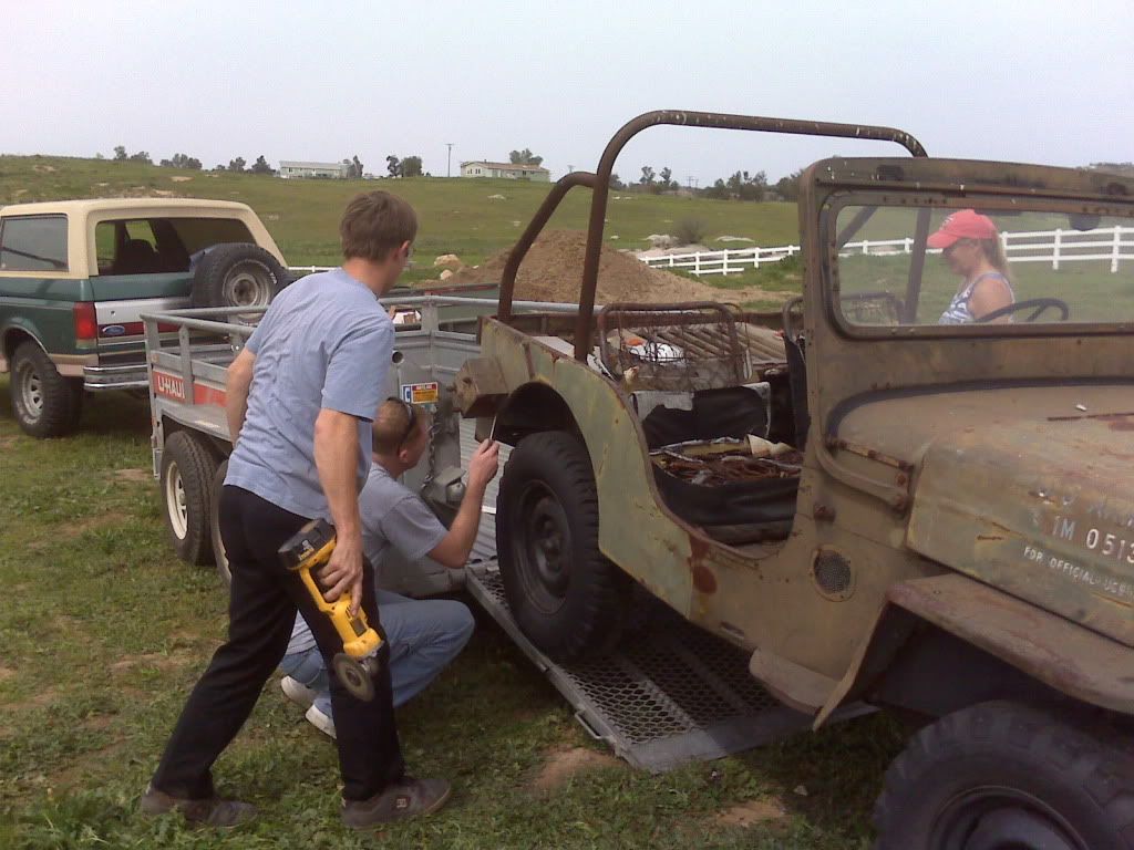

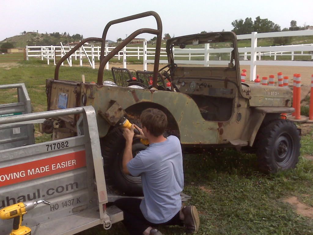

March 21, 2010.
Went to U-Haul and got a 6x12 trailer only to find out its not really 6' wide at the ramp - instead its only 57". So if you ever plan on picking up a vehicle NEVER EVER get a 6x12 to do it... I think the pictures will show you why you shouldn't... lol

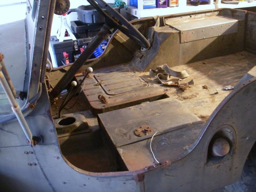

Re: 64 CJ3B restoration

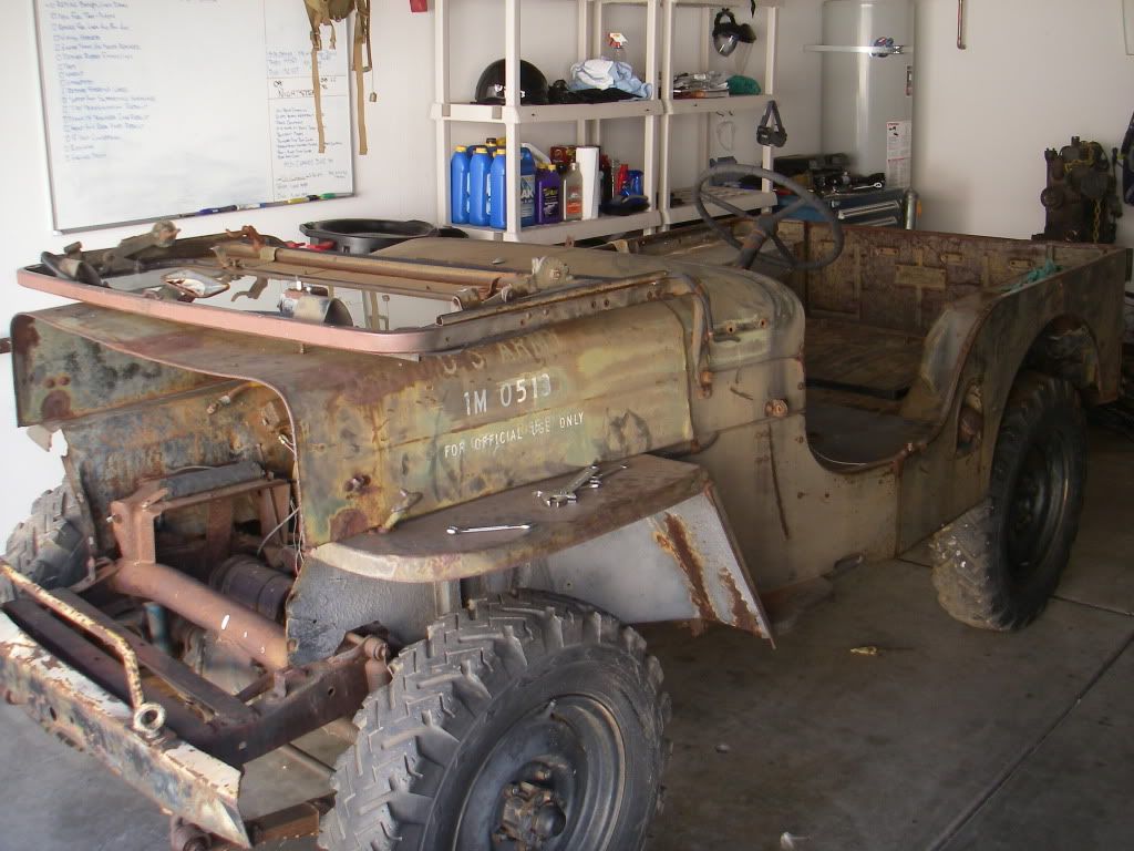

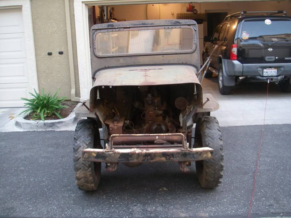

MARCH 27, 2010
Well a week later and I went ahead and got a car hauler from U-Haul rather than a trailer. Worked much better than that 6x12.
First day of having my Jeep in the garage. Day 1 of many!
Blackdog was kind enough to throw in another engine with jeep that is in real good condition. It is a 134 F head as well and has a governor on it - was used as an APU.
Didn't have a cherry picker handy so I turned the roll bar backwards bolted it back down and used cargo straps to lower it onto the engine stand. Very redneck I know...
The start of disassembly... woohoo

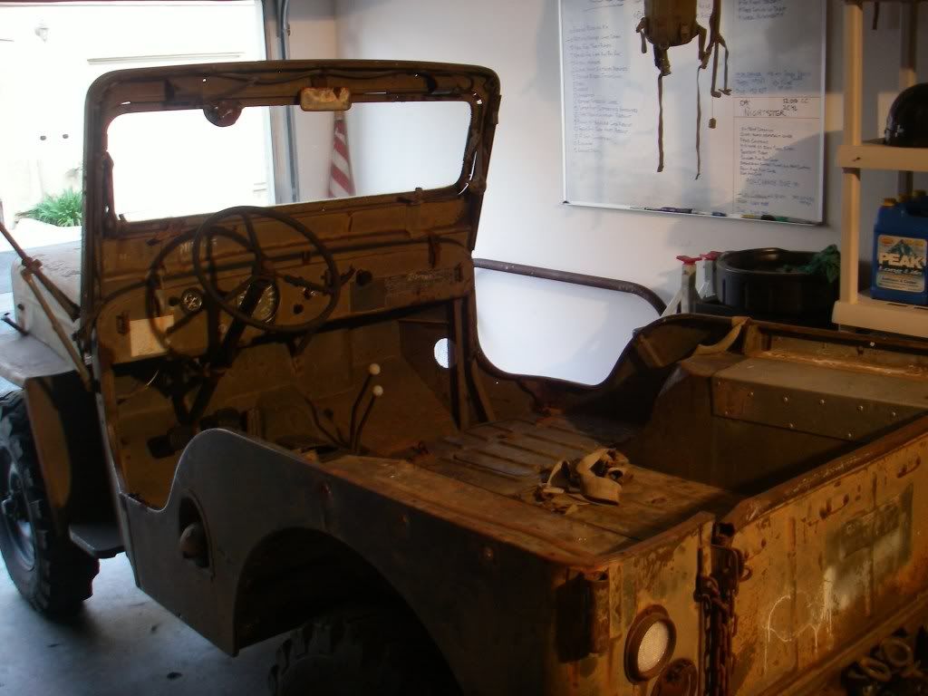

MARCH 28, 2010
Another day of disassembly...

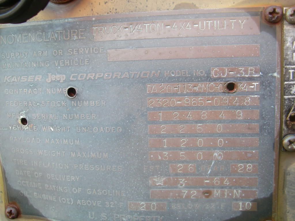

March 28, 2010
Vehicle Markings
Left Bumperette
Right Bumperette
CJ3B not an M606.
Vehicle Markings
Left Bumperette
Right Bumperette
CJ3B not an M606.

Under the tool box lid and some other things where the weather didn't get to it are Gloss O.D.
Ben Dover wrote:The Army bought a few hundred CJ-3B Jeeps in 1964 with Koenig Steel Cabs. Many were for administrative use such as Post Engineers and MP units. They startef showing up surplus as late as 1966 in various states of disrepair and cannibalization. All of the ones I witnessed were gloss O.D. with 600X16 Goodyear NDT tires. and Warn Hubs.

Why's that? Are they rare to come by? Also, what do you think the unit number is on the right bumpreette is? I think on the left it reads TMP... Let me know what you think.

Thanks Ben Dover. Btw, what do you think the numbers read on the right bumperette and do you know what the markings on the hood mean?
Ben Dover wrote:Note the Liggett Springs (grooved), and later type CJ-3B Axles and Brakes.

The hood markings look correct for an Army unit in the 60's.
Since this would make the jeep a Non-tactical loaner vehicle it probably had a license plate ID'g the post or unit.

The USA Registration reflects the system used for commercial vehicles of the time. The 1964 CJ-3B Jeeps I have seen when new and the other 1964 CJ-3B Jeeps that have showen up surplus from that period all had the 1M-XXXX registrations, I still encounter catalogs from DRMO that have an occasional CJ-3B listing USA and Chassis numbers from your batch, they are stashed away with the excess TM's and SNL's that I lack shelf space for. All you gotta do now is save some bucks for the new Goodyear 600X16 NDT's that are in the planning stage. The missing fres air heater components are hard to come by in useable shape, especially in the CL-3B configuration. The familiar under dash Harrison heater will fit just fine.
