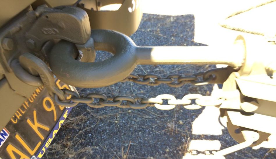

Obviously, something went awry with my chain set up. I bought these quite a while ago as MBT trailer chains. They seem a tad short unless I only drive in a straight line. Back to the drawing board so to speak:
Zeph

Zeph...someone has messed with the LINKS on your chains. You should have two LONGER links, one at each end and NINE slightly shorter links. Like this:
Chain Bantam MBT.jpg (90.64 KiB) Viewed 616 times
