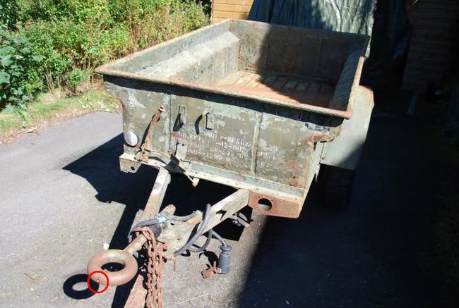

Post by Peewee » Fri Dec 17, 2010 3:59 pm
My lunette has the same indent at the front of the ring as Jhonny´s
http://www.g503.com/forums/viewtopic.php?f=18&t=169783
The axle is a smooth tube, with 8 leafs willys style springs.
The upper shock mounts are Bantam style (nut) for sure, the lower ones are mixed one Bantam and one Willys (splint), but the lower mounts I have to double-check.
My trailer has the "Ben Hur" style chaines installed, if I see correct Jhonny´s TEC trailer chains are the same.
If I remember correct lowbonnets trailer too, so for now I will keep it that way.
http://www.g503.com/forums/viewtopic.ph ... rtation%2A

That "indent is where the Lunette was "center drilled" during the machining operation in order to establish a center to machine the tapers and threaded portion concentric to each other. All MBT/BT3/M-100 Lunettes have that procedure.

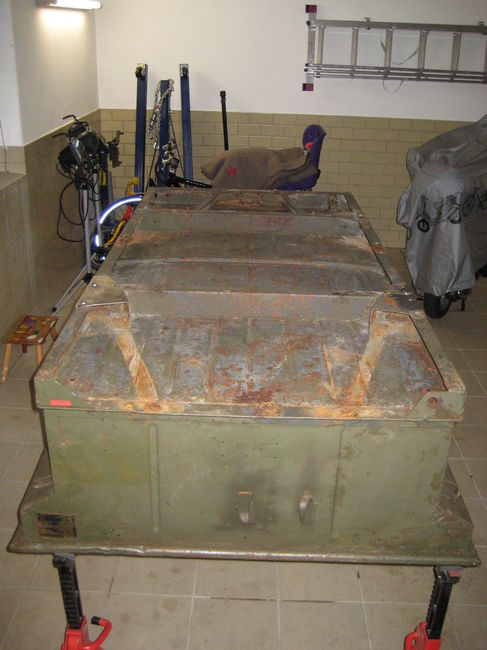

Post by Peewee » Sat Mar 26, 2011 2:23 pm
Today I had the time to dissemble the trailer.
One day of work and all screwed on parts where unscrewed.
I found the the following Nummer 88223, after cleaning the area where the left spring hanger was boltet on.
The spring hangers where attached with EC marked screws, all secured with PAL nuts.
The brake backing plates and the four fender brackets where attaches with EC marekd screws too.
The handbrake and A-frame where attached with BC marked screws.

Post by Chuck Lutz » Mon Mar 28, 2011 9:37 pm
There is only ONE TEC trailer in the data base with anything stamped on it and it is Sven's...but, as he and I have discussed, the data plate on his is a reproduction....and since TEC did not begin production until 1945....a DOD of march 1943 completes the fantasy.
Sven's has an ACM number circa Nov/Dec 1943 and has Bantam characteristics....so it is in fact, a Bantam.
There are other trailers in the data base with a 229th tag on them and they also had ACM numbers from much earlier than 1945.
Since we have only the existing TEC data plates to check out and since more than a few of them in the data base are from Norway and since all of them but ONE have a 229th tag....and since only 221 were made by TEC....it seems reasonable that all/most of them went to the PTO and ended up in Japan, got rebuilt, went into NATO stockpiles and were surplussed.
In looking at them, the TEC data plates have a slightly rounded rivet head on the plate and the 229th tags have FLAT rivet heads on the plate which would seem to indicate they were not put on at the same time with the same machinery.
I don't have any pics of your data plate or 229th tag Jeff....any chance you have some your could send for my files?
