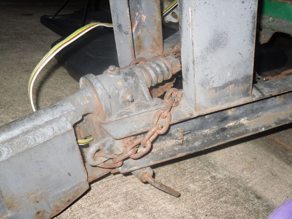

Front Frame, needs the extra structure cut off, the lunette and landing leg repaired/replaced

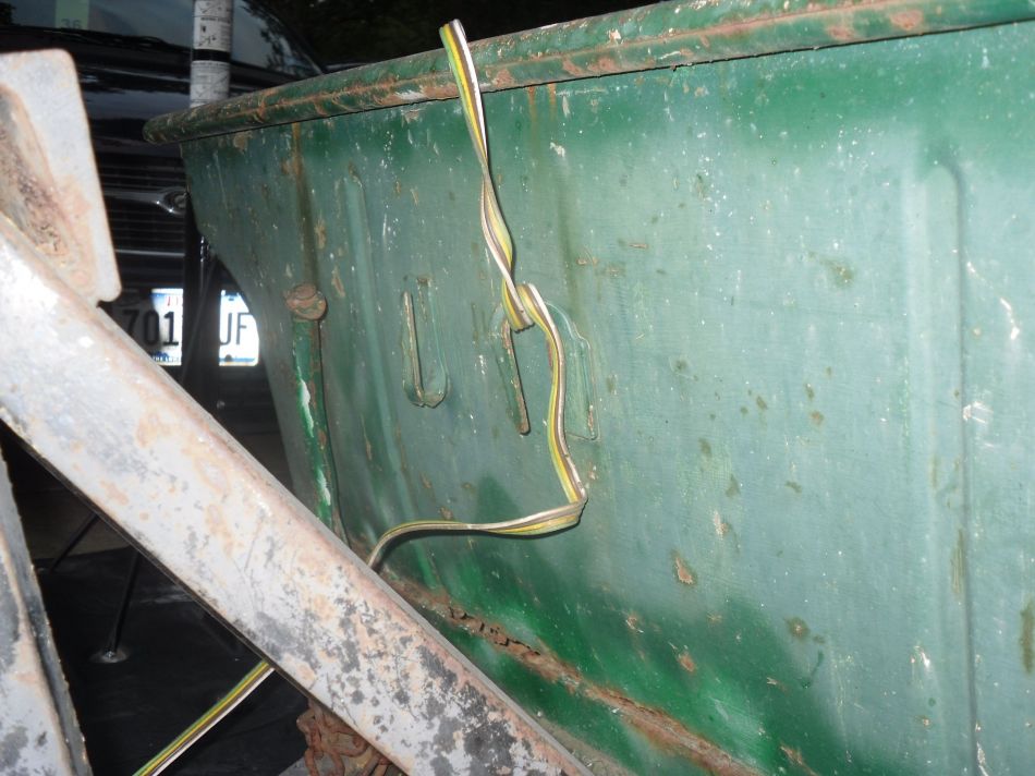

Right Side & Left Side, Are the fenders original?

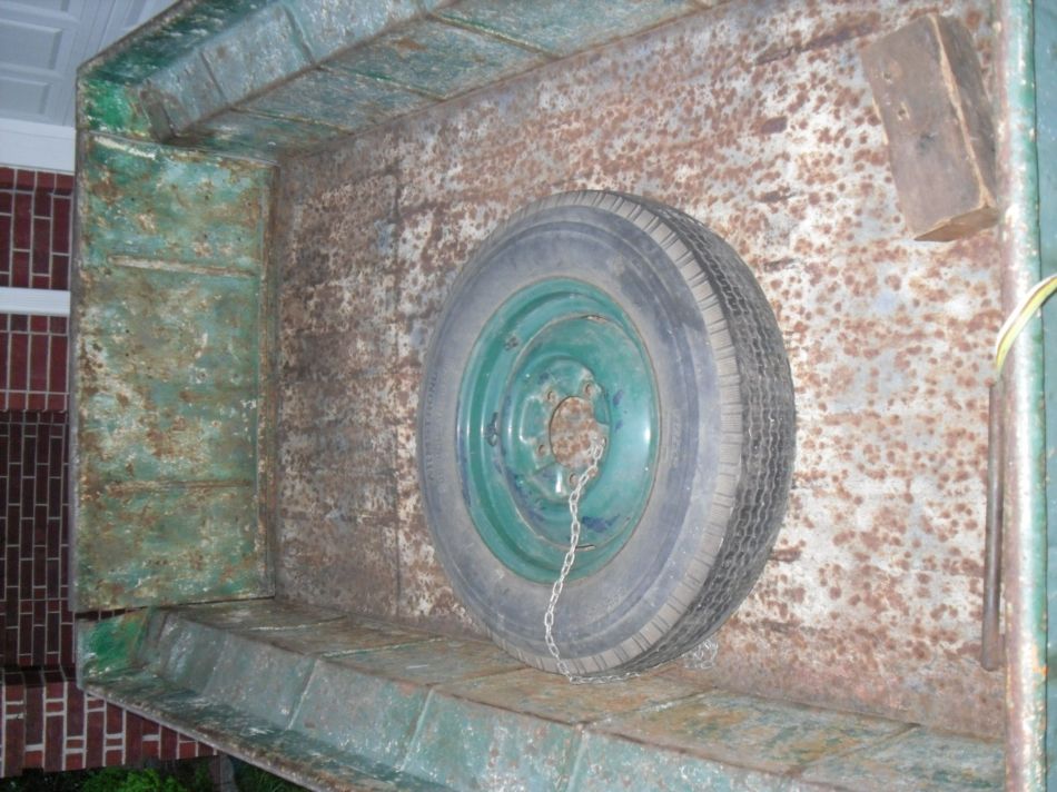

Bed, Spare Tire on Solid Wheel stamped with script "FOMOCO"

Seth....you got a winner there....some good welding will fix the tailgate and a trip to the sandblasters will clean up everything after you have dismantled her...
Send me what is in the "How To ID..." stickey, but from the pics..
1) Remove the "axel bumpers" bubba installed when he "remodeled" it
2) Replace the original axel bumpers (the thin ones not the jeep ones)
3) I see it appears to have COTTER PIN upper and BOLTED lower shock mounts? That will explain why the axel is not the "Cast Center" section one an MBT this early would have.....this is a Bantam Axel with the SEAM and the mounts are THREADED. You might look around and find another Bantam guy with the axel yours would have come with who wants to trade, but that's up to you if a "factory resto" is your goal.
4) The Lunette has "PSC BU-42" which might be a Bantam feature or it might be a replacement feature as I have seen MBTs with a WO part number on some trailers....don't know how ALL MBT/Bantams from the factory had theirs marked or even if thdy did...
5) The welded-on taillight brackets are correct for this serial number.
6) The chain links in the pics look original, can you post a pic of them extended...and check the chain wedge and hooks for cast-in numbers/letters.
7) What are the mfger of the taillight bezels and inserts? They appear to have the hexnuts OUTSIDE, can you see any lead washers on the inside between RH screw and tub?
If you send me the info....PLEASE drop the left front Spring Hanger from the gusset plate and look for an ACM number and the letter "W"...it could be around 10,000 +/- and the W can be above, below, to the right or left of the number...
From this I can work up a DECENT estimate of a USA number for you....

On mine the fenders came off, lunette, drawbar casting, drawbars, landing leg pivot, landing leg, reflectors, chains, axel, shocks, springs, drain plug mount, lights and mounts, handbrake and cable (clean and lube), tires, rims....the brakes are often hardly worn and if clean then mask them off....new bearings and seals...
