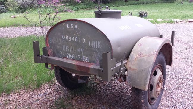

Hello - While looking for my USA number, I found
21FG 25 G-ATC on the bottom rear frame of my trailer.
Any ideas?

Could it be from the 21st Fighter Group....Air Traffic Control? I don’t know much about how to read Army unit information. Does anyone have any thoughts about where this trailer might have been? It also looks like it had Air Force Strato Blue paint later. Any thoughts would be appreciated. Thanks

Does anyone at all have any information or guesses on what these numbers and letters might mean? They were found on the original layer of OD of my Nov 42 MBT. Seems like ATC is either Air Transport Command or Air Traffic Control. Not sure that Air Transport Command makes much sense with 21FG, however. Ahead of 21FG is a white star and an illegible number before that. Any ideas?

Also, is there anywhere else that I might look for more information on the trailer? The tailgate seems to have been sanded, but the paint still appears thick on the front and sides of the trailer.

Could my trailer have been part of the 21st Fighter Group in the Pacific (Hawaii and Iwo Jima) in an Ground Air Traffic Control (G-ATC) capacity? Also found out that the star between the first number and 21FS was an Army Air Force thing. Very interested in what anyone else thinks. My thread is feeling a bit like an echo chamber :lol:

Post by Chuck Lutz » Tue Aug 07, 2018 3:09 pm
As noted, 13021 is a November 1942 production MBT. With that in mind, other MBTs in my data base on either side were primarily found on the West Coast or were found in the AWM (Australian War Museum) records. In both instances, that info would tend to support the possibility that the trailer was in action in the Pacific. I think the next thing to do would be to try to trace where that FG was stationed from 11/42 until the end of the war and trace it to the time it stood down. (Hawaii, Iwo and anywhere else). Then check airfield photos of those bases to look for your trailer.
One more thing, if it was a Ground Air Traffic Control vehicle it might very well have some flight-line colors somewhere or if it did not, it may have holes in the floor that secured the very valuable radio systems used for that.
You should search the photos (if any) from that outfit as well as any Sig. Corps photos and personal websites that might have photos of the group's aircraft and perhaps G-ATC jeeps/trailers on the off-chance you find one with "U.S.A. 0214703" on the rear panel as that is your trailers' USA number.
While the majority of things like trailers were not returned to the States after they way, those units that stayed active in the Pacific retained their vehicles and they may have been shipped with the Group when transferred since a G-ATC vehicle would be classified as a "specialty" vehicle, possibly with radios on board or a genny to provide power to a G-ATC unit.
If you CAREFULLY remove paint all over that tub and on the drawbars, you might find some additional markings either in paint or tapped into the steel. Lastly, trying to contact the previous owners back to whomever bought it from the military might be helpful also.

Thanks Chuck. It’s exciting to have found a little bit of the trailers history! There were no extra holes found in the floor. I’ll very carefully wet sand the front and side panels to see what else may appear. I spent several hours just to uncover what you see in the picture. Too bad it wasn’t in better shape.

I always suggest you use tracing paper and constantly update what you find as it is often the case where you go right through some markings when looking for ones right next to it and that helps in determining things like a 3 from an 8 or a 6 from an 8 or a 4 from a 1 in the USA numbers.
You never know what you will find under a layer of paint so look everywhere and go slow!

Not knowing what the entire trailer presently looks like I would suggest after the restoration to keep the same markings on it. 8)

Totally agree. Now that I know a little of the history, I'll definitely restore it that way. Here are a couple of more pictures.

My trailer also was with the 21st Fighter Group, and was on Iwo Jima.

Seeing the photos I would not “Restore”either trailer. I would also leave the tailgate in the MBT unless you are going to use it for a boat. Once it’s restored, original is gone for good! 8)
