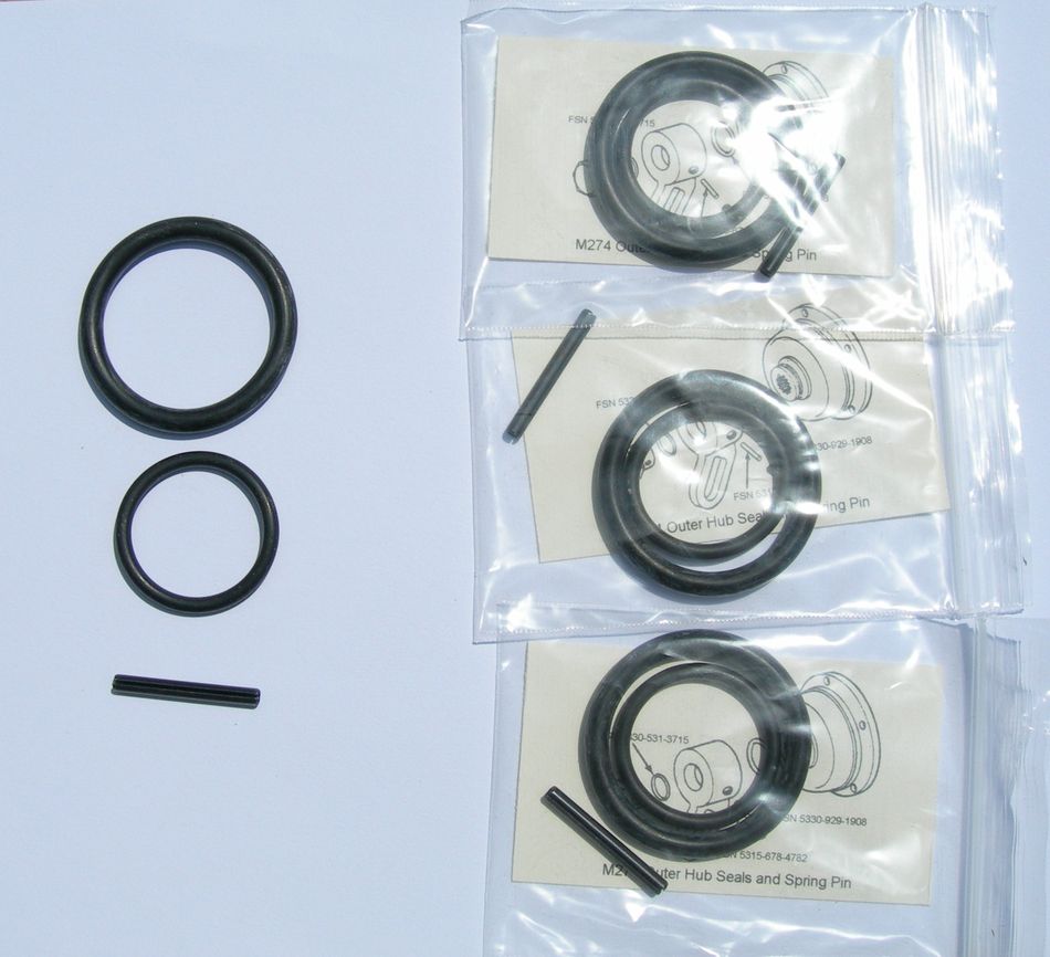

Is there anything special about the "preformed packing" used in the wheel hubs, or is this just Army Speak for "O"rings? Is the size known? And is the seal inside the hub is National 473455?

Standard rubber O-rings. The small one on the axle nut is 1/8" x 1-3/8"OD and the big one on the hub is 3/16" x 1-7/8" OD. There is no seal inside the hub, but the hub seal that goes inside the knuckle housing is a Nationa 473455 for the steer axle and a National 715100 for the non-steer axle.
I sell a package that has the small O-ring, the large O-ring and the axle nut retaining roll pin for $4 per wheel + Shipping, runs about $19 total for a set of 4, PM me if you are interested.
