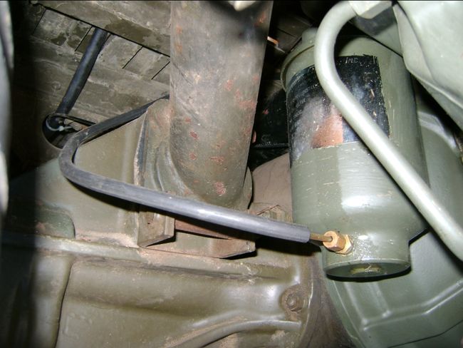

This is one way [about the easiest place] to install an Oil Pressure Gauge this pic is for a Mechanical gauge or you could install an electric sensor in the same place.
Not the best thing to add to your mule as a mechanical gauge exposes ripping the line loose at the filter housing when traveling through thick underbrush.

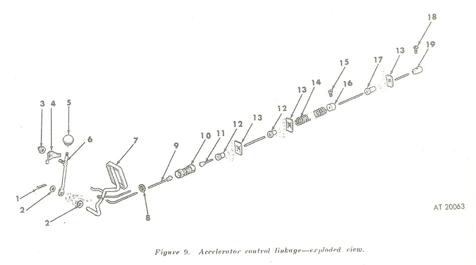

However I cannot seem to get the throttle linkage from carb to governor just right, or the correct setting for the governor stops. Also were should the throttle on the carb rest when not running. Should it be almost wide open and then once it is running should the governor push it closed to the high/low adjustment stop?

With the throttle cable spring between the gov throttle lever arm and the engine block the carb throttle lever screw tip should rest against the carb idle stop pin.

Make sure you have the return spring that goes on the cable behind the front bed support cross member, item #14 below
