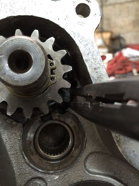

Did not find the Post after a short search so here are the pics
Top Axle is held in with a spring clip
Use needle nose pliers to remove clip from groove.
Once removed use a knee bar or small flat pry bar to pull axle assy from DG housing. I suggest checking the 205 bearing behind the axle gear and replace if worn. Most bearings come with shields and these should be removed and the bearing packed with grease.
Pressing off the gear and bearing.
Tools used.
Removing the B1412 needle bearing. REMEMBER when installing the new needle bearing set it deep enough to keep the lube passage feeding the top gear and bearing open
Tools used.

After cleaning the surface area real good, I did a detailed inspection and the cover seems ok, as well as that 5208 bearing. I think I have a new 5208 bearing so I may change it anyway.
The middle needle bearing that supports the idler gear with the Bronze thrust washers is damaged and Does not appear to be set deep enough or worked its way out. (not sure how that would happen?) The bearing is actually above the surface just enough that it machined in a deep groove in the thrust washer. You can see in the picture the crack on the bearing cage

From your pic the needle bearing case appears to have the rounded edge out. This side of the bearing should be inserted first with the square shoulder out. I do not see a way that the bearing could work out if the fit is within specs. The bearing does not come out easily even with a blind hole puller and a slid hammer.
With the damage indicated in your post I would replace 3ea B1412, Axle 205 and Hub 5208 bearings plus the copper thrust washers on the idler gear. I did not include the driven gear and bearings/cups because you mentioned replacing them.
