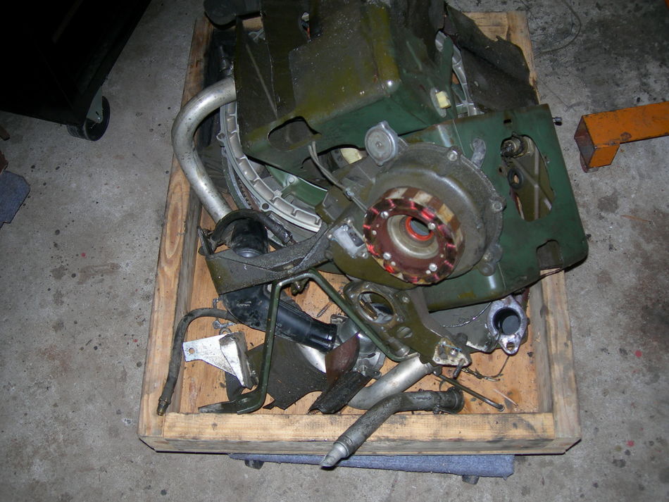

The 2A042 engine tear down is almost complete, however I have a question about the removal of the oil filler tube. I believe I have to remove it to use the MULE engine oil tube. Is it pressed in, threaded? looks like sealant around it. trying to avoid damaging the case. Can I throw heat to it?

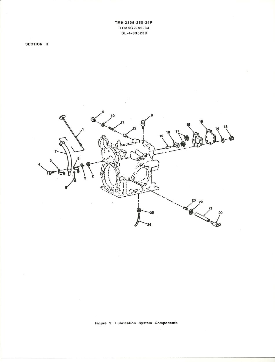

The MULE engine illustrated parts list shows an O-ring but I don't see a part number. At this point I don't have a manual for the 2A042 genset motor.
IMG_2997 (1).JPG (114.34 KiB) Viewed 408 times

It's just held in by an O-ring. DO NOT use heat! Just put a pipe wrench on the tube close to the block and gently work it back and fourth until it comes loose. You can see the gen set filler neck at the bottom of this photo.
TM9-2805-258-24P does not list the O-ring as a seperate part, you will have to reuse your old one or find a matching one at a parts store.

Yup It came out just like you recommended. I put an 18"" pipe wrench to it and worked it slowly cw/ccw then some force in the up position and out it came. right tool for the right job. Of all my tools, I didn't have a pipe wrench so at first I tried with my large channel locks. no dice. cheap harbor freight but it bit good enough with the serrated teeth.
