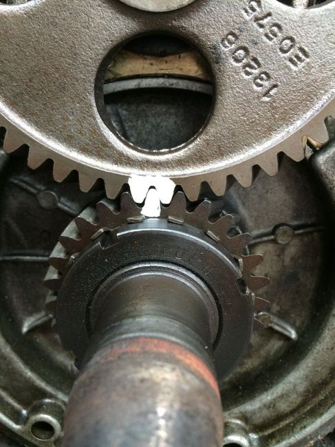

Rotate the Crankshaft until the DOT on the Crank Gear and Cam Gear line up and mark them with paint [White Finger Nail polish] This should give you access to the Cam Mounting Bolts remove the bolts.

Mark the new Camshaft Gear at the DOT [This will assist in lining up the gears when installing the new Cam]

CAREFULLY insert the Cam and line-up the teeth of both gears. Let the Cam Rotate as you push it in you may need to assist with a hammer handle lightly tapping. If the Crank Gear never moved then the Cam should slip into the Oil Pump Gear.

Mark Timing Teeth
