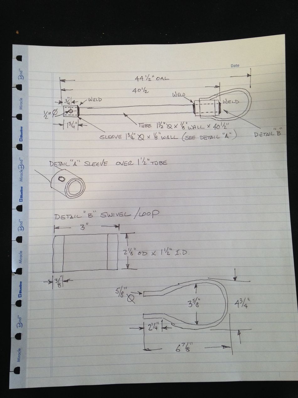

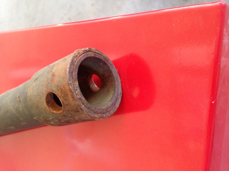

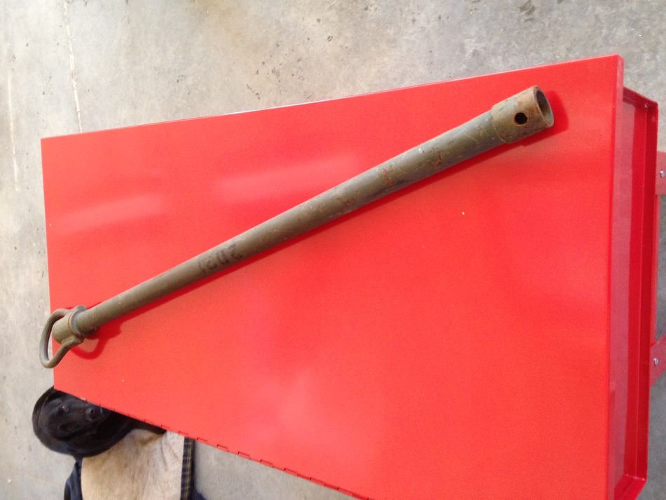

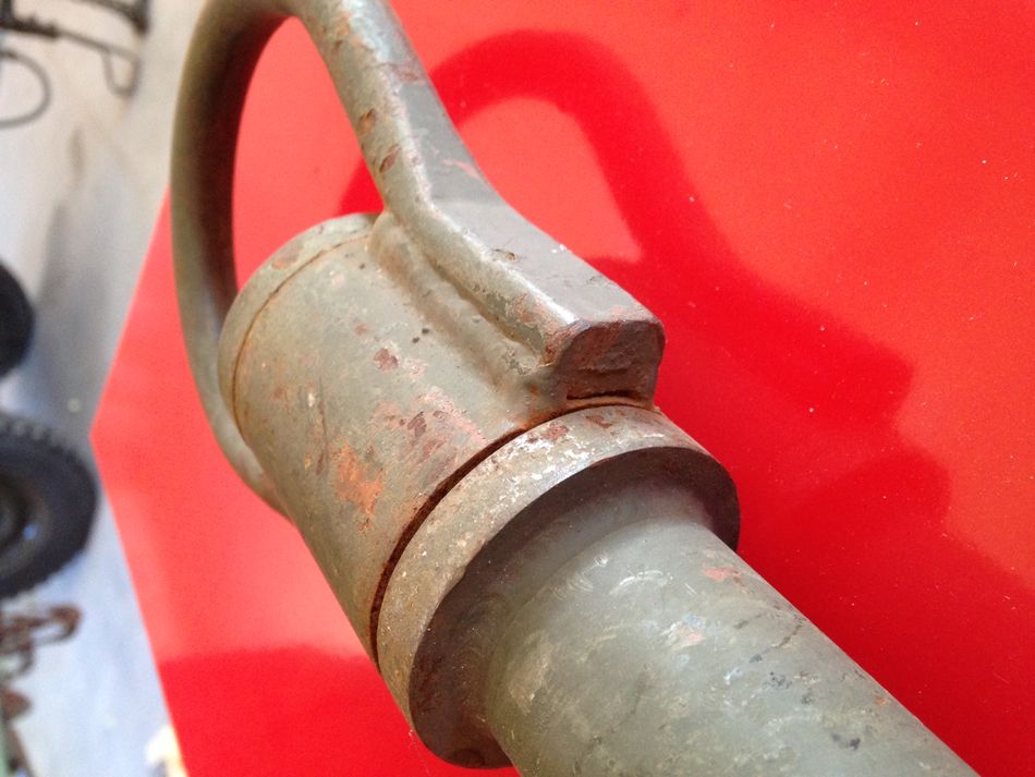

Post by Chuck W. » Mon Feb 23, 2015 10:12 am
Thanks to Chris and Tom for the following information. Please feel free to add additional photos, drawings, etc. We'd also like to see photos of your finished product.

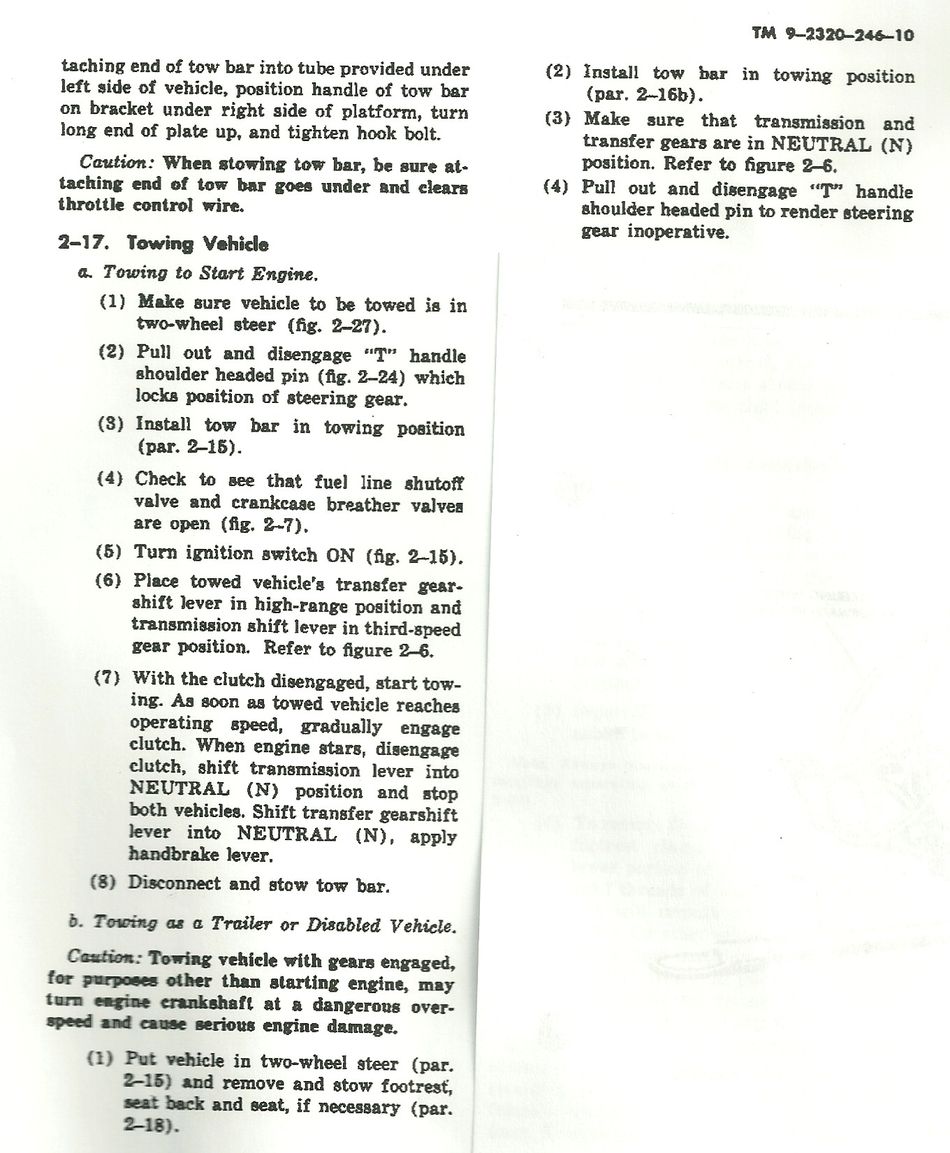

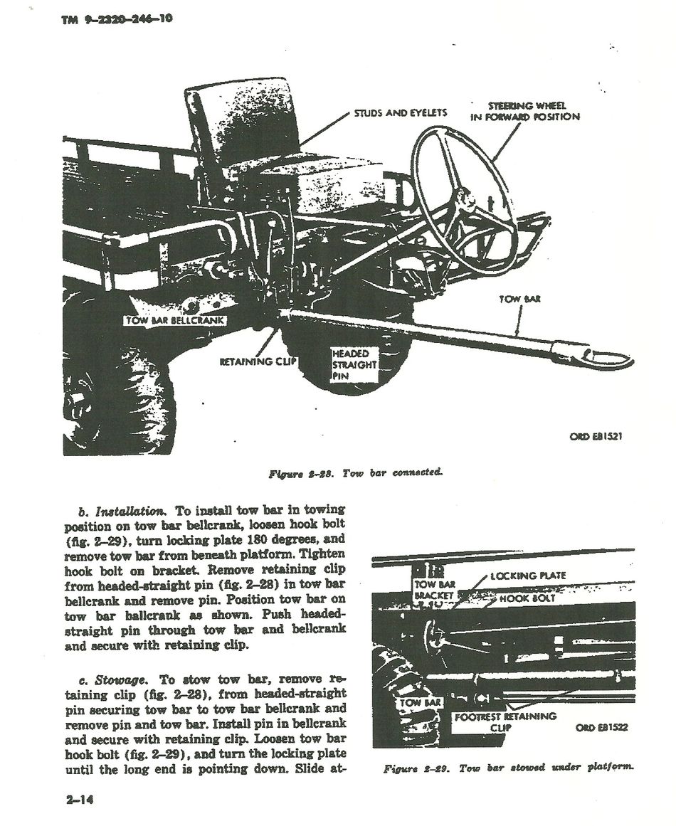

Post by Chuck W. » Tue Feb 24, 2015 6:27 pm
With all the talk about tow bars, I thought it might be helpful to post the towing instructions from the Operator's Manual. TM 9-2320-246-10
There are a couple of things you MUS do before you tow your mule: Steering should be locked into 2-wheel steer, the steering arm on the steering box must be disengaged by pulling and turning the T handle locking pin, and both the transmission and transfer gears must be in neutral. From my personal experience, I'd add, don't try to back up!
