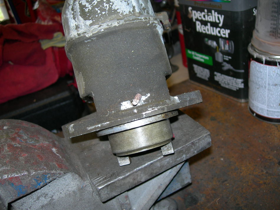

The evaluation mentions that a magneto failed on the AO42 engine during the test... then a modified AO53 magneto was used to complete the test. Any idea what modifications were made to the 4 cylinder mag to make it work on the 2 cylinder motor?
Bruce/nw5s
1968 M274A5 Automatic Sprinkler Corp
Chuck W.
Posts: 5314
Re: Mule Models, Manuals and Publications
Post by Chuck W. » Fri Mar 07, 2014 9:02 am
That WOULD be interesting to know! From what little work I have done on the 4-cylinder magneto, I would think it would have been a job to make it work, as the 4-cylinder appears to have an external impulse unit and a tang drive instead of a gear drive. I think it rotates in the opposite direction, if that would even matter.
On the other hand, it may have been as simple as making a different drive gear adapter, since the case and mounting appear to be the same size!
