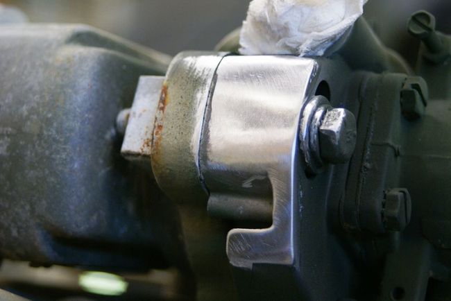

Pics of the genset engine I converted to a mule engine. I cut off the oil filter mount from the timing gear cover to eliminate removing it and replacing with the mule timing gear cover. Saves time and a gasket/seal.
Contact me via E-Mail see Contact Info for further help or parts.
I installed NOS or NEW mag, governor, carb, ignition cables, spark plugs, blower, fuel lines and a rebuilt original fuel pump.
Lance-W's pics of 2AO42 Timing Gear Cover Modification,
