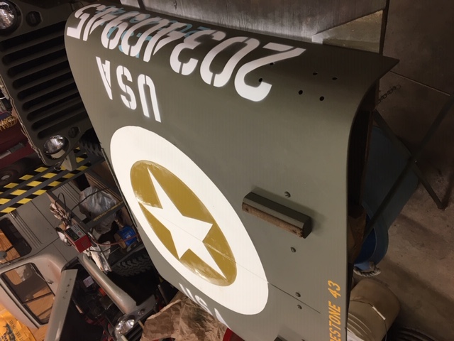

You did what I'm trying to do, white over the blue registration numbers. Yes, the stencil bled too. My hood circle and vesicant were brush painted so I tried to copy that look. I got Kindergarten art project hood instead! Too embarrassed to even take a picture!
Oh man, I think we have all been there. I can recall a few instances where I didn't post a photo of a disaster. I did pick up one of these rollers for the paint mask stencils to if it would help with the bleed through. It's already come in handy for a few little projects:

I’ve got one of those. I’ll give it a try. Yesterday I sanded what needed to be “corrected” but left most of the brush marks, taped off the star and circle with pinstripe tape and sprayed several light coats of the same paint that I tried to brush on. The results were much better. The brush strokes still show through giving the effect I was looking for. Today I hope to do the white registration numbers and tomorrow the vesiccant color.

The roller worked so well on the side stars that the star stencil ripped the corner as I tried to remove it for use on the other side.

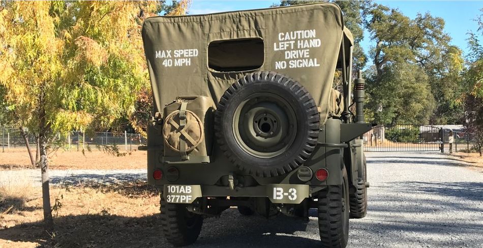

Zeph, aren't your bumperettes up-side-down?
"WET PAINT"
Attempting to mimic what remained under about 1/8" and three layers of green, black, and orange paint.

Looks pretty good.
Yes, the bumperettes are upside down. It came that way as that was the way it was marked and outfitted on the PO's father's Jeep during WWII. He has a photo with the bumperettes upside down. I made a metal note to flip them right side up before I stenciled, and then totally zoned it until after I was completed! Oh well, eventually I'll order another set for the bumperettes. I had to make the B-3 stencil with a X-acto knife which wasn't too hard, but too much work on the driver's side stencil for me.

The rear bumperettes were reversed to help protect the rear spring shackles and it also makes it easier to step on the bumperette that has one continuous surface to contact your shoe, boot or whatever. I will send you some photos of jeeps with the bumperettes "reversed" when I find them again.

Hi Frank. Yes, I had a relative in the 91st Bomb Group during the war and he told me they were flipped upside down to make it easier to stand on. Here's a 91st photo I have had for some time:

I was shooting for my cousin's husband's Jeep in WWII. His bumperettes were upright as delivered. I meant to flip them like this, but totally zoned it:
