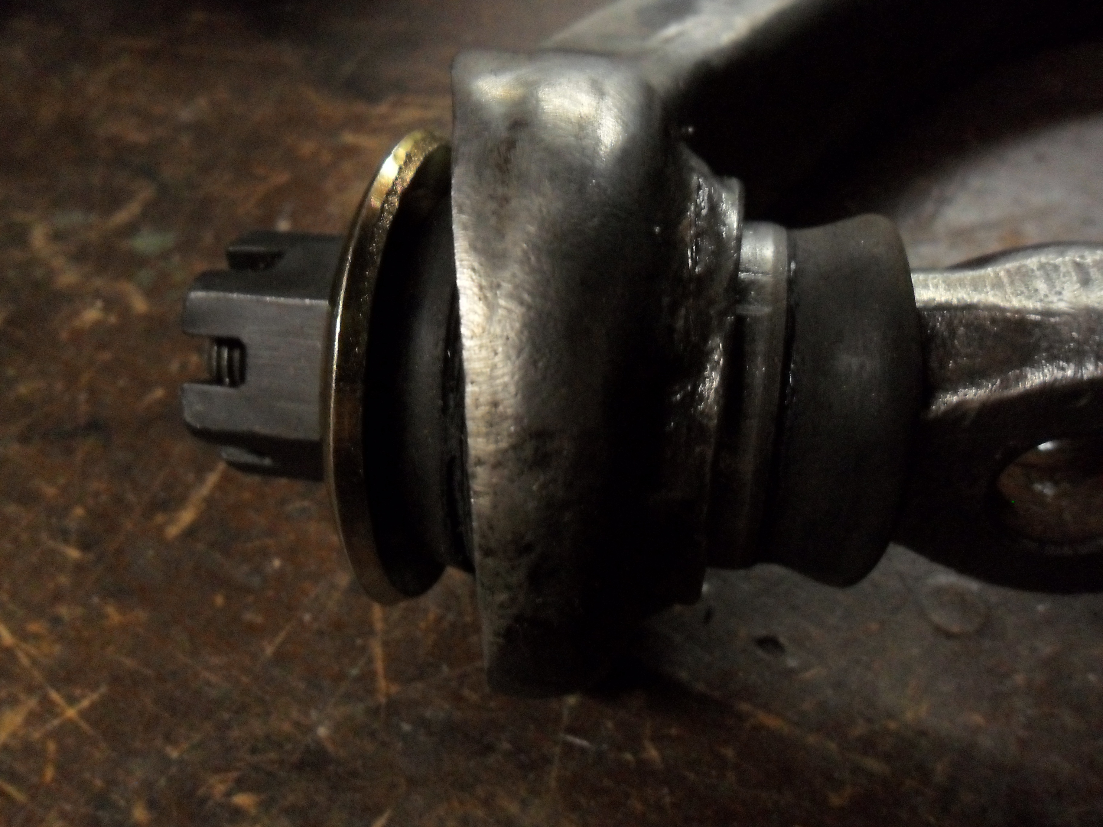

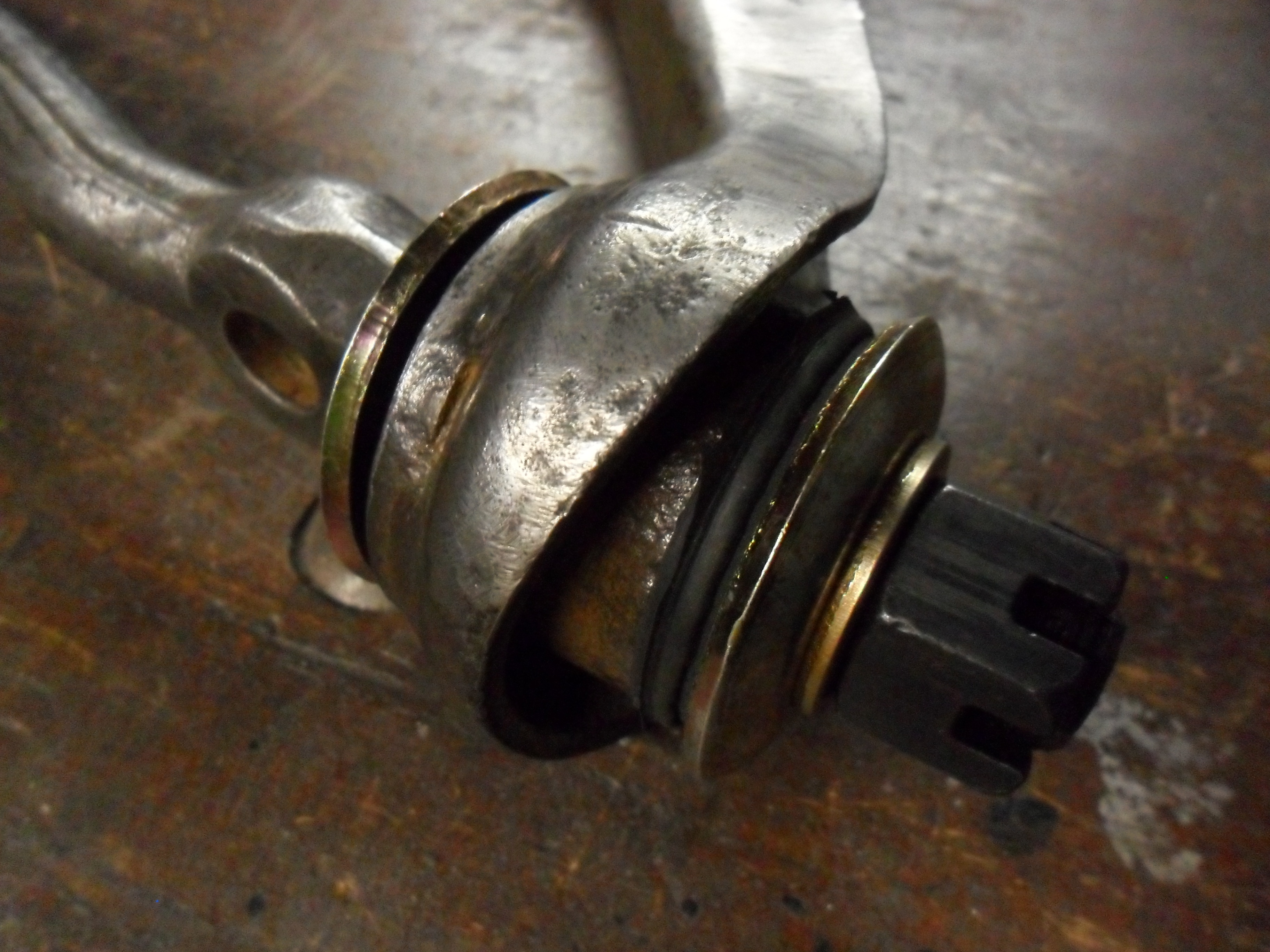

hello, i have a question , i replace my control arm bushing upper
my bushing seems longer on one side, in the kit there was a longer one, it doesn't look good to me, can you tell me what you think? thank you so much

The only thing I see is it looks like you are missing the inner retaining washer on the one side. And do not fully tighten those nuts until the full weight of the vehicle is on the suspension, then tighten them up. You want the bushing rubber to be in a neutral position when the vehicle is sitting in it's normal resting position. Once those nuts are tight the inner bushing does not move at all, just the rubber twisting. If you tighten them now then when you set it down the bushings will be under a constant strain.

thank you for your help, in the new bushing there is only an interior washer and originally it's like that too

Ok, I only replaced one set and it was years ago, ever since then I have replaced the entire control arm. I will have to look at mine since you have me curious about that washer. I have a half dozen front suspensions out back to look at. :roll: :lol: :lol: :lol:

hi
they are crossed
upper side the short one at the back site the long one at the front side
below side the long one at the back side the short one at the rear side
