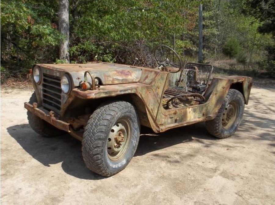

Posted: Fri Sep 21, 2012 6:36 pm
by gerrykan
Listed as a 1954 :shock: model in the craigslist ad. I would assume it should have an X in front of the M151 on the data tag if true.
Re: M151 Related
Posted: Sat Sep 22, 2012 6:55 pm
by Rickf
My guess is that it should say 1964. It is an A1. If I could see the front floor and the right rear tail light I could tell if it were and early or late A1. Straight 151 did not have turn signals, that one has them and the boss's that they mount on are in the fenders so it is not just a set of lights mounted on an older 151.
Re: M151 Related
Posted: Sat Sep 29, 2012 8:40 pm
by Star Electric Ordnance
I also noted that the engine has a mechanical fuel pump, the oil filter base does not have the low pressure oil cut out switch and that all the vent lines from the distributor and oil presure switch are missing.
Re: M151 Related
Posted: Sun Sep 30, 2012 4:56 am
by Rickf
Star Electric Ordnance wrote:I also noted that the engine has a mechanical fuel pump, the oil filter base does not have the low pressure oil cut out switch and that all the vent lines from the distributor and oil presure switch are missing.
I noticed that also, just figured someone put in an A2 engine. That is a strange looking fuel pump though. Also the PCV valve and all of its lines are missing. There is a lot going on with this one.
